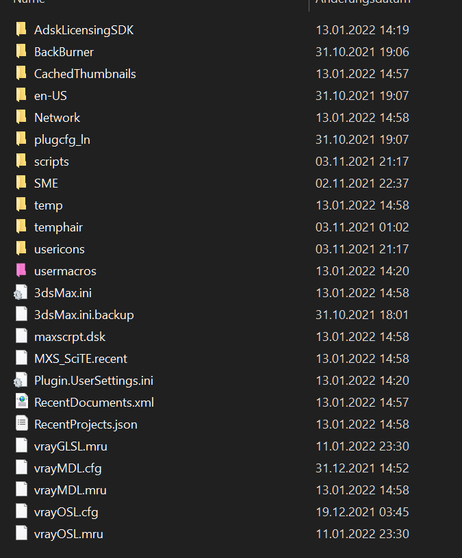

        you can also delete/rename this folder: c:\Users\<user>\AppData\Local\Autodesk\3dsMax and restart
          Okay thanks, right, it solves it, when I delete all those preferences.
          Do you know, which preference from the folder I really need to delete?
          Of course, there are several adjustments, which took a while to configure...
          Thanks

            Unfortunately not - never took the time to examine things like that. I saved my Layout, Keys, and Colors and load them again after renewing/ deleting Settings. In most cases, I have still my prefs then and the problem is gone =) Wich one of them the devil is - I don't know.
