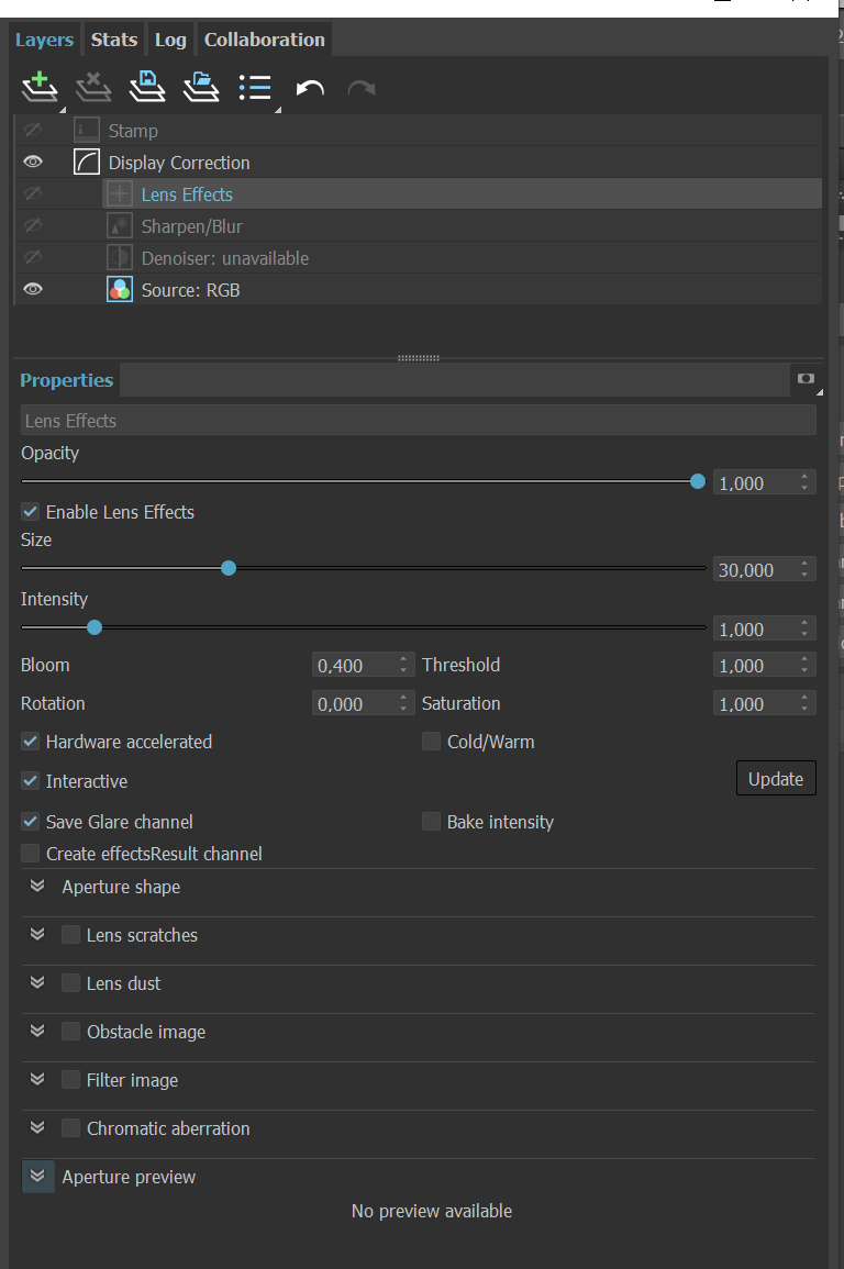

    Optical? Do you mean like a stretched lens flare similar to the ones produced by an anamorphic cinema lens?
    We have this panel in VFB that gives a lot of options.​

        Hi! Well, I just spoke with devs and unfortunately we can't produce this effect in V-Ray. It's called Ghosting. In real life, it's a result of all the small lenses inside the tube of a lens. In our case, we do not represent these optical elements in our camera. So in order to produce something like this, we need to create a profile of all the characteristics of these lenses.
