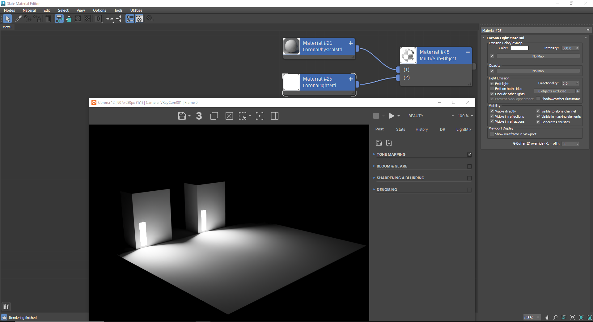

                    I was hoping that you could integer the Corona solution, where the light material is not affected by this, I know that both are different engines and codes, but I dont know, maybe study a different aproach
