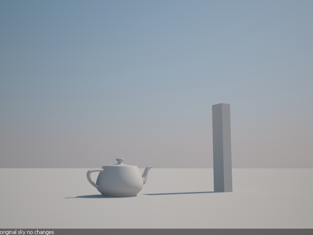

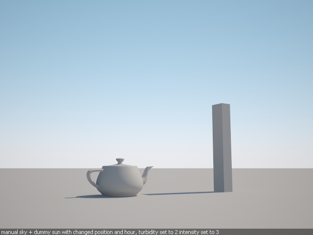

However, there's issues using Linear Workflow with the current Vraysky on exteriors with the Physical Cameras. The skies tend to either be too dark at certain exposures or a very bright cyan - you can never really find a vraysky that looks balanced using LWF. It also doesn't seem to be producing enough GI at default levels. I've tried putting the vraysky in a colorcorrect map at 2.2 gamma and this still doesn't work.
Here's a few image examples can be seen from this thread:
http://www.chaosgroup.com/forums/vbu...6&postcount=25
http://www.chaosgroup.com/forums/vbu...0&postcount=31
I believe there is something wrong with the Vraysky and working in LWF. Can this be fixed? Thanks.
