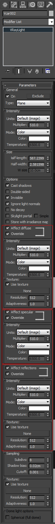

Lights :
Vray Light
Extra bar options to control diffuse/specular/reflection >
Also opacity map for texture slots. So if I use white circle as texture to cast light I can use alpha to get rid of the black background thats left...
And maybe can we have separet Subdivision samples control per each specular/diffuse/reflection/shadows ? I've noticed that to get smooth specular I need high samples, however I dont need that much for shadows and diffuse so would be helpful...
Edit : Bah forgot to add, exclude for each option too so I can exclude/include some objects from reflection and so on ...

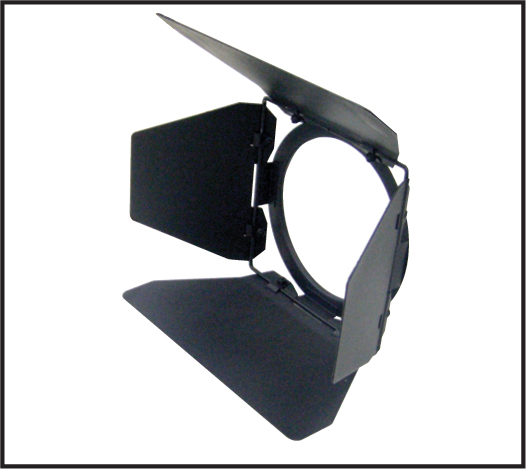

Lights barn doors :
Basically
But let me also chose a custom model, I did try it with 3ds max models but weird things happen with GI... had to go up and it was messy time consuming insufficient... will try it again might get it better tho...

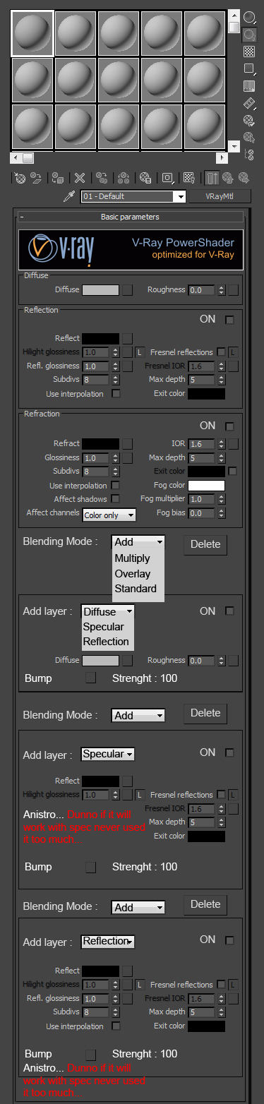

Materials :
Universal material
Basically we have what we need/want as many as we want. I always struggle with blending materials that got bunch of usseles controls that I have to keep eye on... This should be easy. I thin that I should also add BRDF not sure tho, I never change it hehe...
Also crucial thing that I need is BUMP for Reflection/Specular and not Diffuse slot. Mental ray got it from years, I'm surprise vray didn't got it back in sp 1.5
