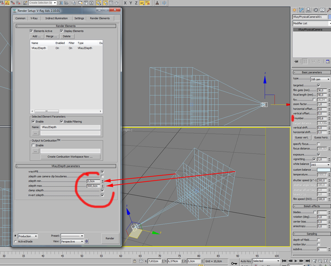

I have a request for z-depth channel. I think it's simple but usefull for me.
Usually i use vray phisical cam to set up my scene. I tweak F-number to set up the the depth of field to blur the part of the image i like.
Sometimes i disable DOF in vray cam ( to produce fast rendering) and use zdepth to make post production.
IS it possible to have a button to put the phisical cam RANGES in the z-depth parameters?
Every time i have to mesure it manually and it could be not so "real" as the phisical cam ranges.
I made a screen shot.
let me know if it's a bad idea....
