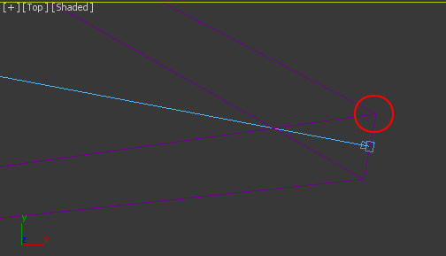

              At the moment, I am rendering about 90 different Vray Cameras. I keyframed the stereo eye/focus distance for each camera.
              The renders look fine, but I want to bring the left and right Vray Cameras into after effects to do further compositing.
              My current method is the one that was mentioned earlier in this thread: I clone the center camera twice, then translate and rotate the cloned cameras until they are as CLOSE as possible to the left and right eye virtual cameras. Very hard!
              I'm wondering if there is any way at all to speed this process up, or make it more accurate? I've attached a picture of the top viewport in Max. Is it possible to reveal the co-ordinates of the 2 left/right virtual cameras (one circled in red), or even allow me to snap or align the cloned cameras to those locations?
