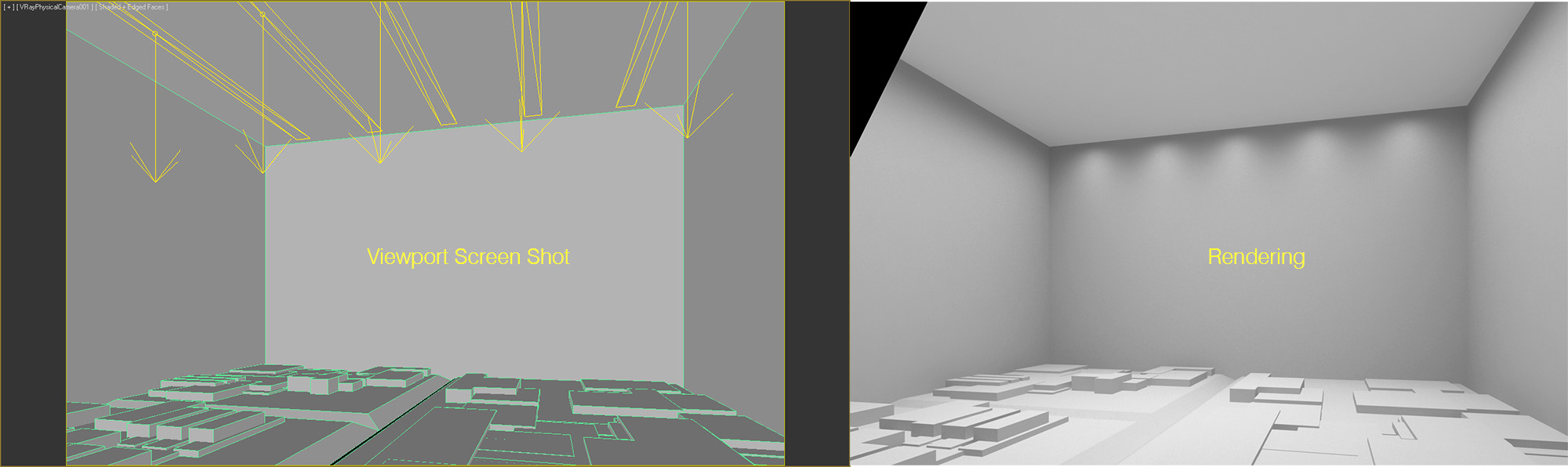

          Not sure if this is related, but the VrayCam clipping planes do not work correctly when combined with vertical shift camera correction. Clipped geometry is not visible in the viewport, but still renders if the clipping planes are too close. The image below shows a simple example. Anyone else had this issue?

            Switch off camera correction and that's how the clipping planes are - they've never worked with any kind of camera correction. If you desperately need to work around it, keep the camera horizontal, add height to the image you're rendering until you see enough at the top and stick to rendering crops.
                Yes, V-Ray physical camera clipping plane doesn't respect the camera shift correction.
                This is a know issue, which is reported to the developers already.
