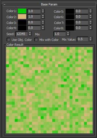

Isn't it possible to randomly assign the colors to the objects using the map based on a separate seed that has nothing to do with Object or Mat IDs?
I'm not sure how MultiScatter Texture does it exactly but it doesn't seem to be linked to any Object or Material IDs.

Yes, we need the colors to be consistent between all frames of the animation, so it can't be based on the position of the object. We need the colors to be the same for the whole object, regardless of the mat id of the different faces.
For XRef scenes, it's important for the colors to be the same when the scene is rendered separately and when it's used as an XRef. E.g. if a box is blue when I render my file, it should remain blue when somebody xrefs my scene and renders my box.
We mainly need this for randomizing colors of cars and vegetation in big scenes.REDVERTEX

I think that the best and easiest way to do this is just extend the "Get ID from:" list of the VRayMultiSubTex with a few more options. This map already has great features and adding few more options how to distribute the maps(colors) will make it even greater.
Here is a list of options that can be added:
Name, Node handle, Render ID, Element, Face, Particle ID
If you are using xref scenes you can choose Name to keep consistency. The other five options will be great added value to the map.
