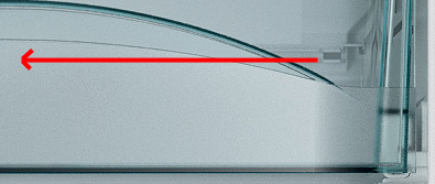

      Here a specific case where I also am in need of an alpha mask for Vraylights. A product vis. Usually I split the lights for diffuse and specular/reflection
      to have more control. I often place reflection lights per object using include/exlude. I´m using a global reflection environment and as said vraylights to bring highlights
      to specific objects only. When using maps on these vraylights, like a gradient to soften them, you´ll get ugly edges because the Vraylights are blocking the environment.
      Using a Light Material is not an option because neither include/exclude nor reflection only is available. See both attached images. One to show the problem, the other one
      an actual example (the red arrow shows the gradient I´m doing with a reflection only light, using a gradient for intensity, including only this specific object).
      For the moment I get around this problem by adjusting the dark colors of the gradient until they match the environment. But that can be pretty time consuming.

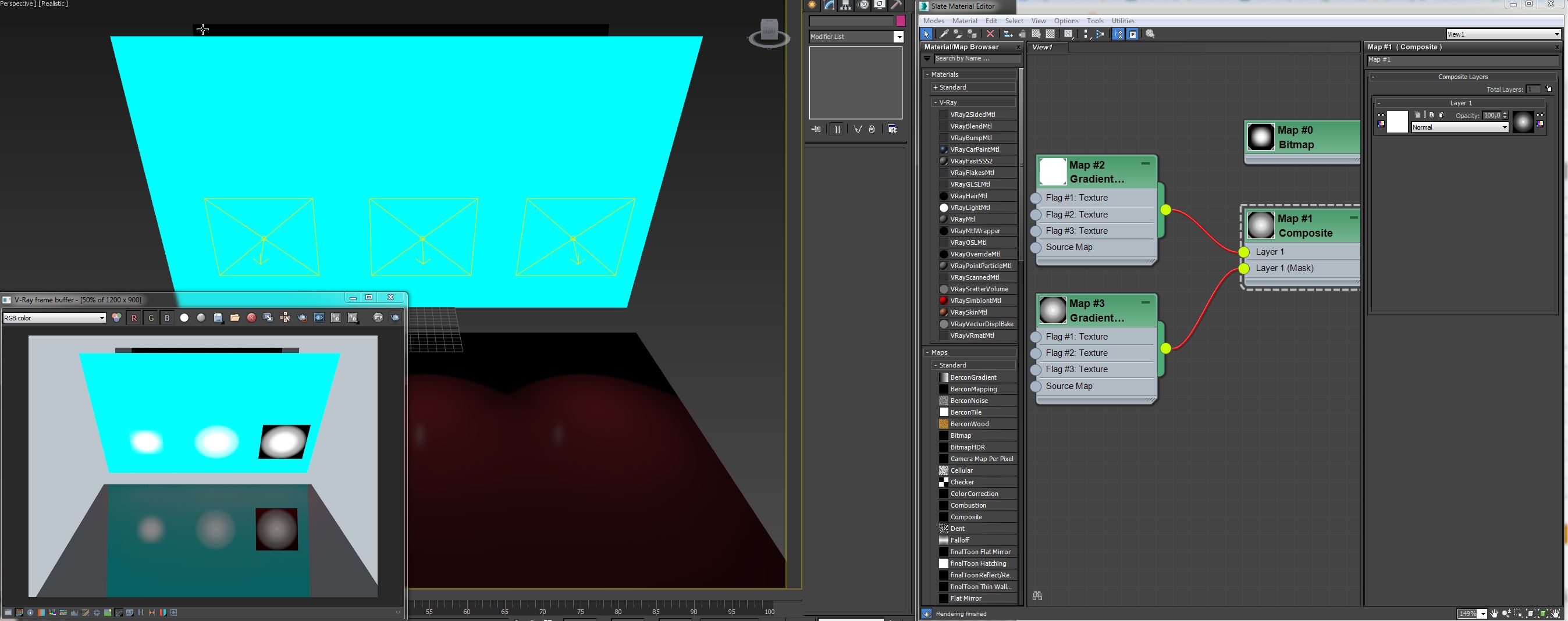

        I think that this is already possible, a texture with alpha channel can give you the requested result. The same could be achieved by using the 3ds max Composite map by placing a black & white texture (gradient in this case) to the opacity slot.
        I'm attaching an image to show the render result:

        Tashko Zashev | chaos.com
          Tashko's workflow is correct, I have been doing this for years. Another option is to simply check the Alpha from RGB intensity checkbox, if it is something simple like a gradient on the light...
            [ATTACH=CONFIG]23342[/ATTACH]
            The solution with a composite map works great. Thank You !
