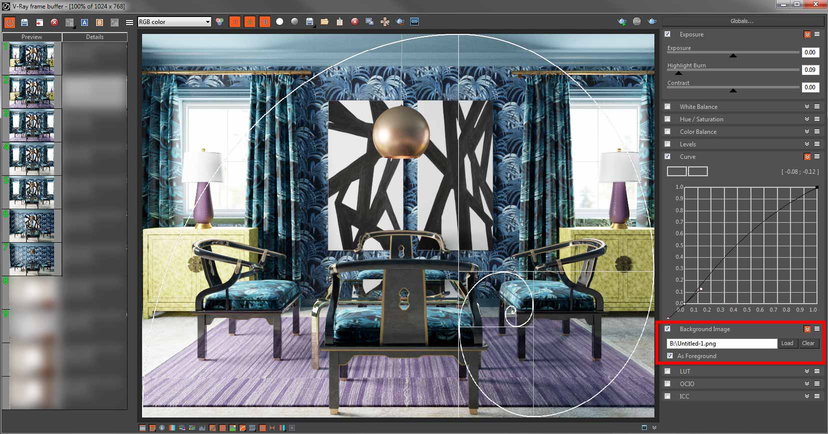

That would be nice addition. Actually, you can already do this. It's a bit "hacky" but I find that it works. Just load a transparent PNG into the "Background Image" rollout in VFB (make sure you also enable "As Foreground") and you'll have this image overlaid over your render. Not as fast and elegant as a built-in solution but should do the trick for now. You can try with this image.
Another way to do it is to use the ImageCompHelper script but it overlays it over the viewport instead of the VFB.
Here's an example of the 1st method:
EDIT: Warifus beat me to it!Aleksandar Mitov
