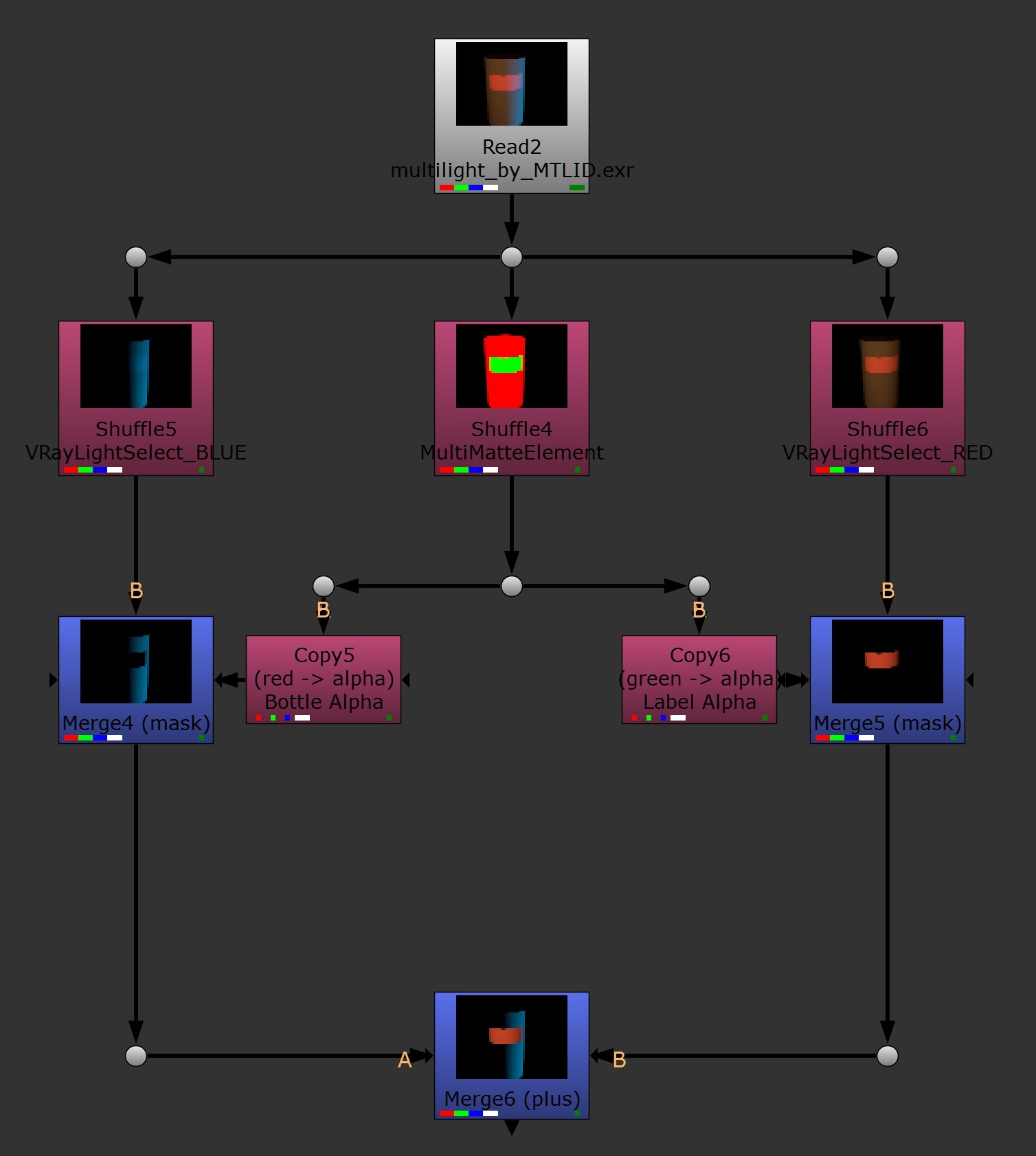

                      For example, i'd contend you could make this work right now, using MMs (with matIDs) and light groups with LightSelect REs. One setup, render, a bit of post.

                          a combination of masks by material ID (MultiMattes in MTlID mode) and full lightSelect render elements would allow you right now to have both lighting setups affecting both material IDs, and then to freely, and very quickly, split and recompose as you wish in post.
                          See the attached max file, i'm sure the comping part will be obvious.
                          multilighting_by_MtlID.zip
                          I'll attach an example comp, and the results as contact sheet.
                          edit: thanks for this Manuel. In fact, with Adaptive lights, you could throw at a single scene as many "light rigs" as you pleased, to render in one go (properly split in their REs, up to, i think 64), and then be mixed later through one-click, perfect masks. Your issue, revisited in light of the new techs, has opened me a pandora's box of possibilities.
