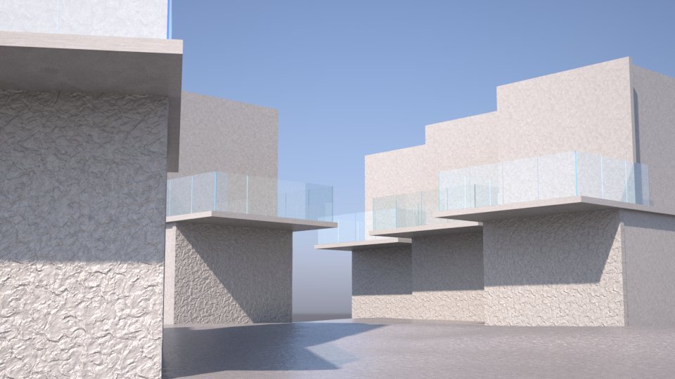

    Hi,
    Since Vray 5 forces now the use of BRLC method, my worst nightmare comes back - ugly, unbalanced image noise
    90% of image is ok, 10% (mostly unlit corners) has x5 times more noise, which only improves with lowering threshold - but still stays visible, where the rest of the image is clean and rendering times skyrockets.
    (This is where the latest IRLC method with detail enhancement was superior sometimes)
    How do you handle those noises?
    (Please don't mention any denoising methods.)
    Exterior scene, Vray Sun with sky.
    Walls contain only diffuse noise, no reflections. If somebody is curious I can export a scene, but it's rather common setup.
    Threshold 0.02 (raising min/max subdivs does not change nothing here )

    I don't mind having a look on your scene, since I wasn't successful trying to recreate the "unbalanced" noise distribution.
    Render times are trickier to compare, but these shots have displacement on the base wall and similar (I guess) to your diffuse noise setup.

      Thanks for the interest Yunal.
      Basically, what you did is heavy bump, which looks in distance like noise. So hard to spot the GI noise, but it is there.
      Scene also needs little more complexity.
      Most of the scene is on current setting acceptable to the eye, but the balcony corners, shadow parts stand out dramatically. For me it's a common problem wit Brute Force. Even on 3.7 I tried to switch from IRLC to BRLC, but many interiors just had those ugly spots, no matter how long would you render. Wondering why min aa setting does not help here?
      Leaving you soon a link to scene on private message. Try with higher settings. Just render as is 0 frame:

              Hi RwVision
              is it possible for me to get a link to the scene as well? I'd like to take a look at it as well since I've recreated something similar here, but I can't really get the same noise.
              Do you get the same amount of noise when you have the noise threshold to something like 0.005 with the default 1 and 24 min/max subdivisions or with new default settings preset? Do you get the same amount of noise when you do a global material override with a gray or white material?

                    Hi RwVision ,
                    Thank you for the scene. I've made some tests and to me, it seems like the Bump amount of the material (0.65cm) and having Noise shaders in both Bump and Diffuse is also heavily impacting the image looking noisier. I've created a new Render Settings preset to avoid any unwanted legacy settings if the scene was converted and the only few parameters I changed are the Noise Threshold from 0.01 to 0.005 and the Sampler from Progressive to Bucket.
                    Here are tree renders from the scene that you send me where one of them is a straight render without material tweaks, the second one has a lowered Bump amount (from 0.65 cm to 0.1 cm) and the third one is without the noise shader in the Diffuse channel so you can see the amount of noise produced by the sampler.

                    In my opinion the Noise shaders in the materials need to be tweaked to achieve a cleaner result since the noise isn't primarily produced by V-Ray. If you want even cleaner result feel free to lower the noise threshold to something like 0.003. Since you're not using a denoiser here are some raw render times from my tests to give you an idea on how long the rendering takes.
                    Noise threshold: 0.01 - 1m : 30 s
                    Noise threshold: 0.005 - 2m :10 s
                    Noise threshold: 0.003 - 2m :40 s
                    Let me know if this works for you.

                      Many thanks Ivan,
                      (The whole scene was created as new in V5, so no changes here.)
                      Basically, that's not an answer - 0.005 is already way too long to render, compared to other sections of the image.
                      Diffuse noise must stay and it's not the main problem.
                      GI noise is still present in those areas. If we would use old IRLC method with detail enhancement we would have long gone those noisy areas.
                      Whole problem lies in those tiny areas, which force unnecessary calculations on the "easier" parts of image.
                      Please look closely on roof corner, where there's no noise shader in diffuse - whether it's 0.005 or 0.003, it's still noisy:
