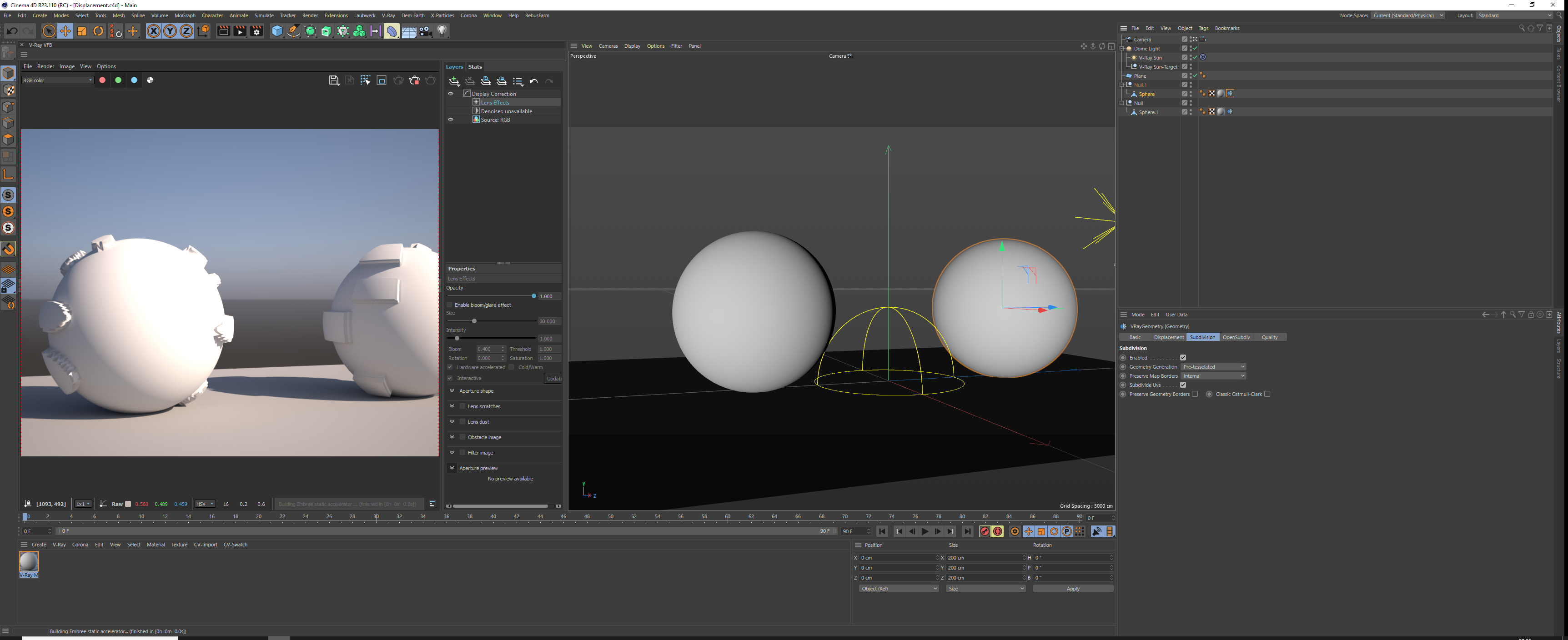

    I have 1 object with a displacement texture in a geometry tag. This renders fine (see photo 1)
    If I add a second object with a different displacement texture in the geometry tag, the rendered first object gets the displacement map from object 2. (as in photo 2)
    Is there a way to get different displacements on different objects? Now I can use only one.

    So, same here... worked only, when I switched on the subdivision on only one Tag
    Simple file attached...
      I switched the subdivision on in only one tag and now the displacement is correct. For now it's a workaround for this weird bug.
      Now I can try this in the project I'm working on. Thank you.
        hope it will be fixed soon, as displacement is very elementary... thanks to your post I can see whats wrong on another scene I am working on
          Hi, this is a bug on our side, that may happen if two objects have exactly the same underlying geometry (which happens when you clone an object). I have logged it for fixing and it may soon be fixed in stable nightly builds.
