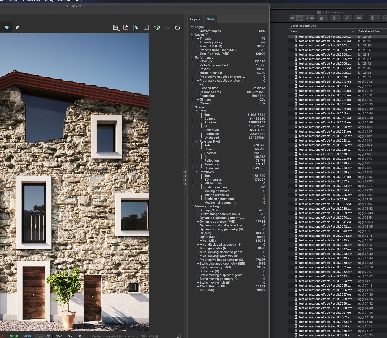

            Hello,
            long time ago we discussed this problem... I am still experiencing this issue, even with the actual builds...
            So there is no progress and this problem is literally a real time and cost killer...
            Couldn't this become more attention?
