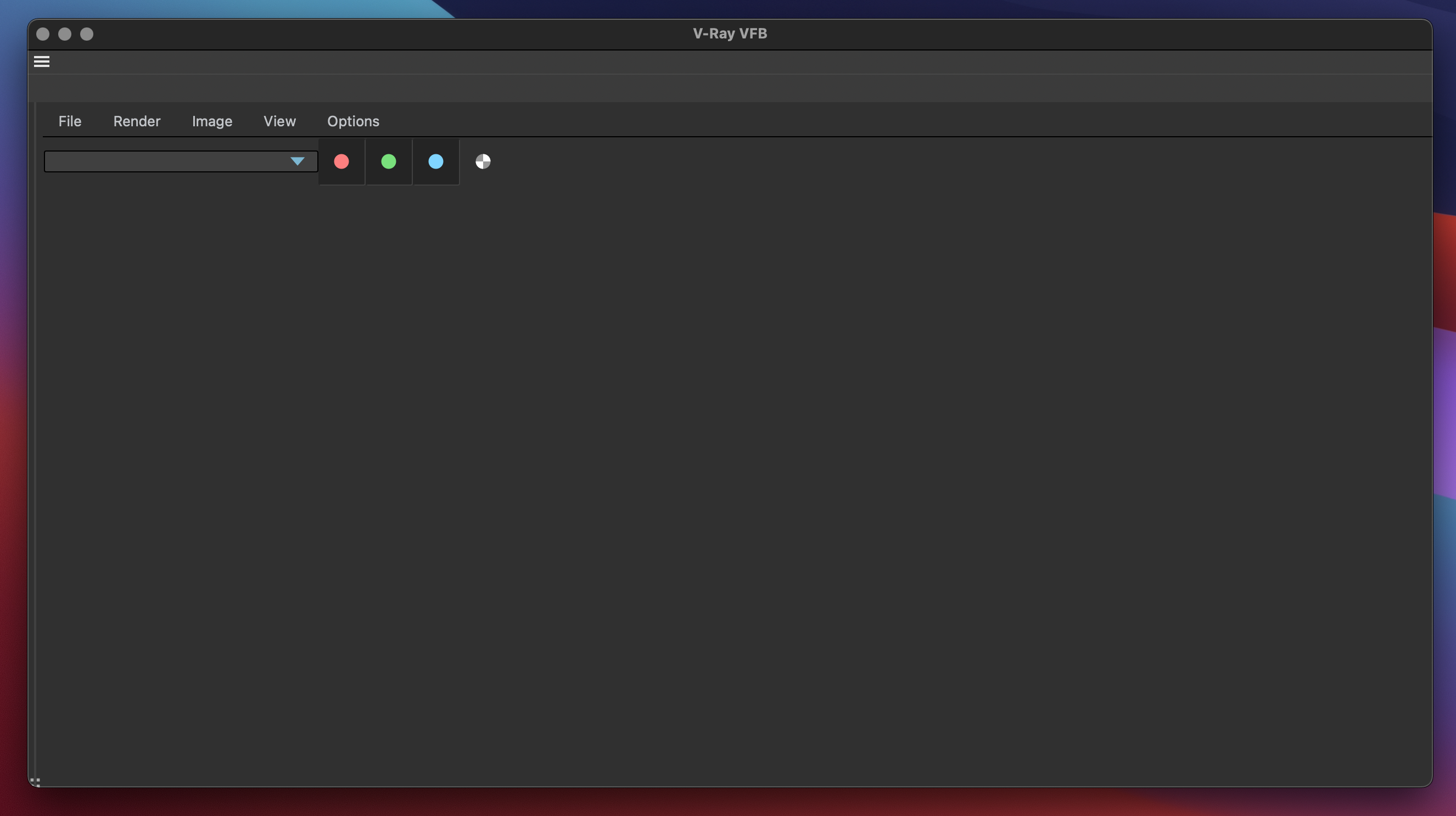

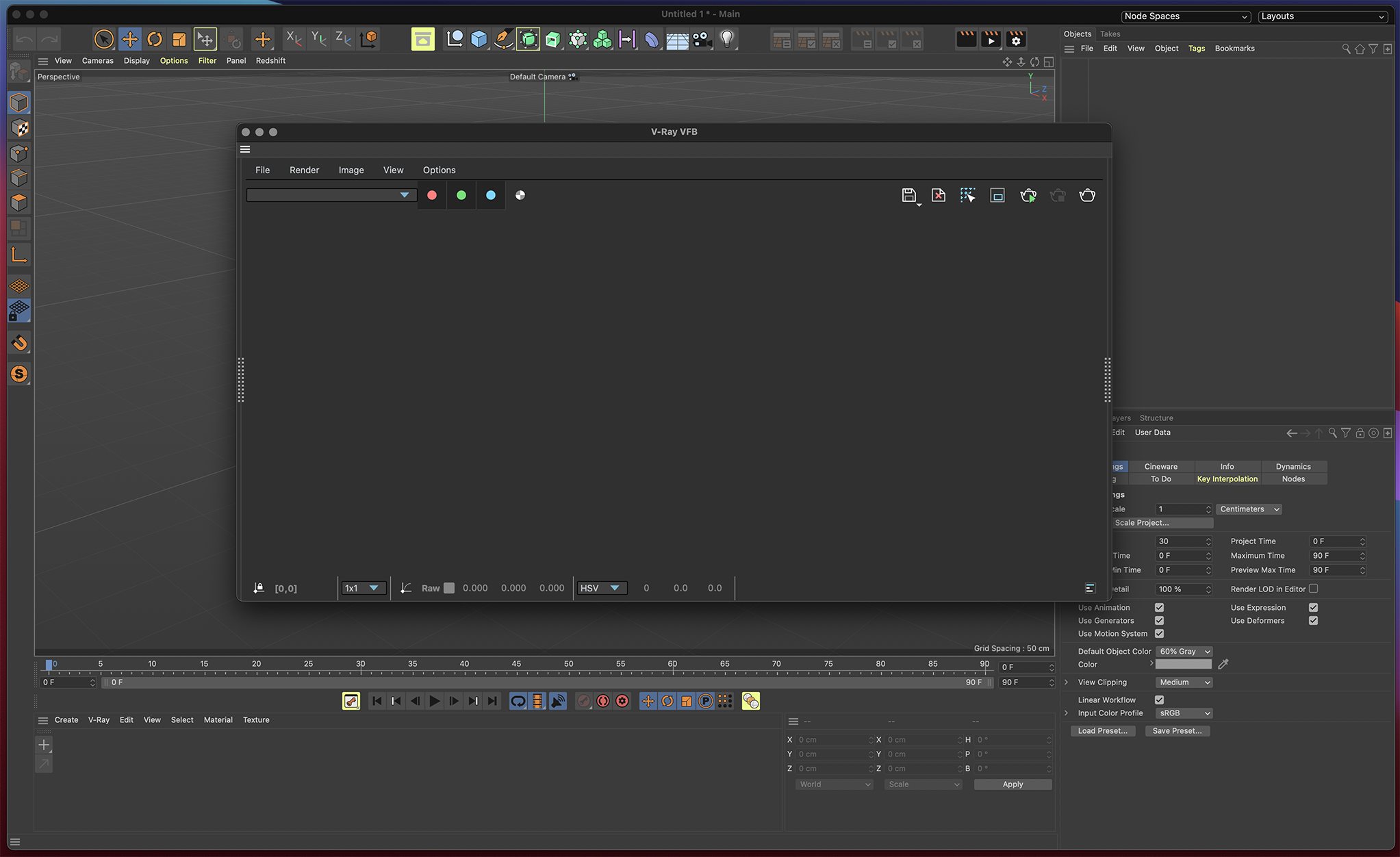

    Hi. I'm running V-ray for Cinema 4D on a MacBook Pro with an external monitor. I noticed the other day that if I open the VFB window and move it from the external monitor where C4D is running to the MacBook display, the VFB loses the render buttons to the right. I found that if the main C4D window is on the laptop display, the VFB window opens fine. However, if I then move it to the external monitor, the VFB appears to be taking up only a small portion of the overall window, and resizing it doesn't do anything. I have some screen grabs in case they're useful:

Name:	Screen Shot 2021-09-15 at 3.40.40 PM.png
ID:	1124862 VFB window moved to laptop display—buttons missing

Name:	Screen Shot 2021-09-15 at 3.43.21 PM.png
ID:	1124866 VFB window moved to external display—doesn't fill window

    I was about to post this same exact behavior. If I move the VFB or Cosmos window to another screen it doesn't fit the window same as your screenshots. This does not happen with native cinema 4d windows, only the vray windows.
    I am on an iMac Pro running macOS Big Sur 11.5.2
      Hello,
      This is a known issue, caused by different DPI settings for both monitors. It has already been reported (bug ID: VC4D-1086) and I will let you know once we have more information on the matter.
      If you set the DPI of the MacBook as the DPI of your external monitor the issue won't happen anymore. Alternatively, once you move the VFB window to your other monitor, you can use the additional menu at the top left corner and "undock" the window. Thank you.
