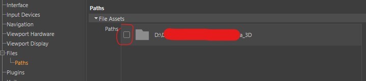

                      • #26
                        Hi H_923874 sorry to ear about that ... we run also on Rysen 3990 machines but also hapen on Intel I9.... not the scene converter situation but the material slow preview...
                        to disable the material preview go here (image bellow)
                        hope this can be fixed...
                        best

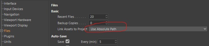

                              • #30
                                Hi all
                                first apologies for the late answer
                                in fact after the last update, all the things become more smoth, even with large images, so thank you Chaos Team
                                but what really makes the difference (and this tip, thanks to stefan Laub) is, first have always absolute textures path when pushing a texture and second is turn off the paths in C4D preferences. Apparently even you have the textures in the project folder, C4D still searching in the paths you have in preferences... I can make a small video, although this is now much faster with this last update
                                the only stepback is that when you have textures without absolute path, C4D will try to search and if you don't have any path in C4D preferences, C4D will not find...
