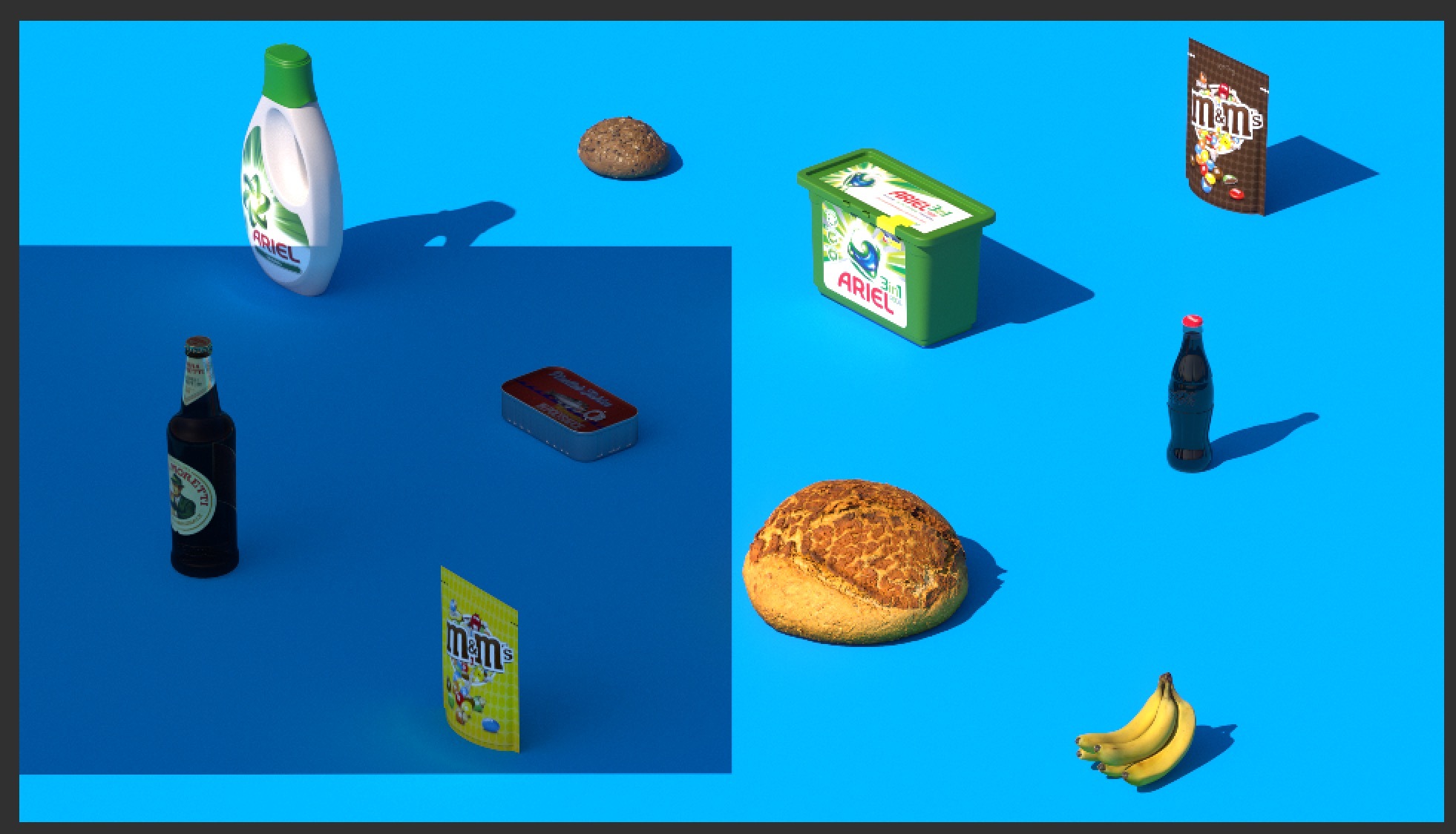

                          I'm still having an issue with weird render artifacts when using Vray sun and sky. Again, it only works properly when I change the lights from Adaptive to Full Evaluation in Overrides. The scene uses the Floor object, but i'm not sure it's that, as the scene above didn't.
                          There's also errors regarding overbright values too. I've updated to the latest Vray version as well. Has there been any movement on resolving this – I sent the scene above over a month ago.

                          • #14
                            Hey KernitTheFont ,
                            We're still looking in to solving the issue since we weren't able to reproduce it with the your scene at first, however we did have other reports and managed to replicate the same issue. We will update the thread when we have more information about the issue.
                            Thank you for your understanding.
