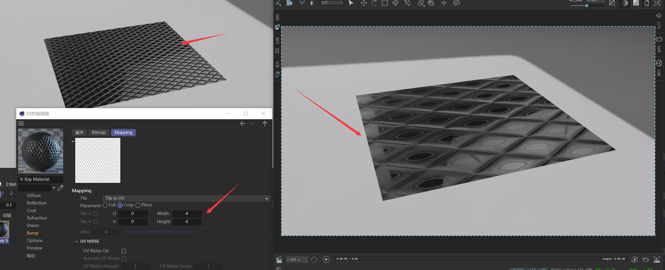

When Vray links vantage, the scaling of bump map cannot be applied. Is this a bug
  • When Vray links vantage, the scaling of bump map cannot be applied. Is this a bug
    Diffusion and normal scaling are normal, but bump scaling does not work
    Hey,
    I am happy to see your report, I appreciate that. Yes, indeed, that option is not implemented into the vantage project. Keep you posted about it.

      So how do I scale the size of bump map or Bump map scaling is not supported at the moment
        Hello 123456_,
        I am afraid that the bump map is not scaled correctly when a scene is exported to Chaos Vantage. This has been reported as a bug before (bug ID: VC4D-1284) and we will let you know once we have any updates on the matter.
        You can check the thread, where this was initially reported here.
