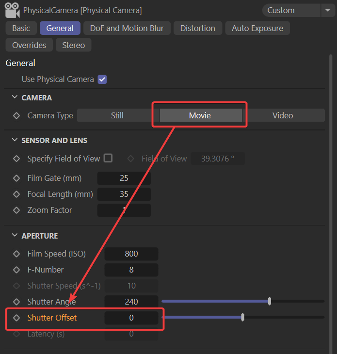

      We changed a bit how motion blur works when V-Ray Physical Camera is used as the active camera (to align V-Ray for Cinema 4D with how other V-Ray integrations work). Basically, if you are using a Physical Camera, only the Geometry Samples from the Render Settings are considered. You can modify the Motion blur interval center using the Physical Camera's settings (depending on the exact type of the Physical Camera):
      Basically you can change the Shutter Offset only for Movie Camera types with the dedicated parameter in the camera. Having the Shutter Offset to 0 will always set the interval center at 0.5 of the duration.

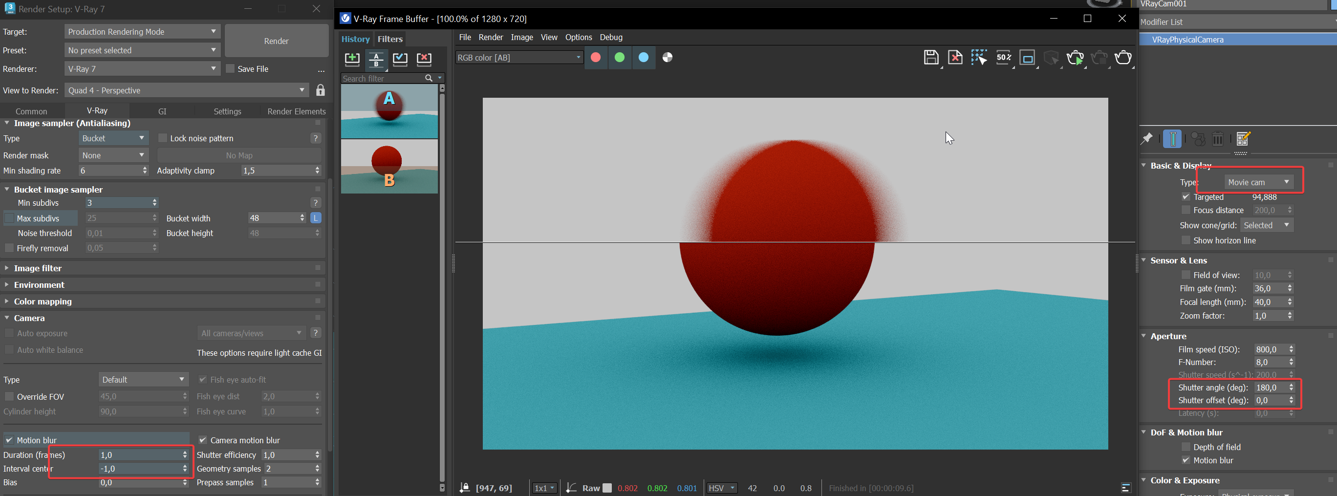

        sure, here's my testscene and a screenshot showing the problem:

        yes, a workaround is the movie camera with offset -90 degrees (180° shutter) this will give us the correct centered motionblur.
        but in vray for 3dsmax etc it's usually the interval center 0.5 to get matching motionblur.
        in c4d changing it to -1 or 1 will not change the motionblur at all.
        thanks again,
        basti
          in c4d changing it to -1 or 1 will not change the motionblur at all.​
          The Interval center is considered only when the camera is not a V-Ray Physical Camera. This is true for both V-Ray for 3dsMax and V-Ray for Maya. Same as in V-Ray for Cinema 4D - interval center is considered, only when you don't have a V-Ray Physical Camera tag on the active camera. Here is a screenshot from V-Ray for 3dsMax (with V-Ray Physical Camera):
          Unfortunately, before V-Ray 7.00.00, the V-Ray for Cinema 4D integration did not behave like the rest and always considered the Interval Center in the Render Settings. While this is convenient in some usecases (like yours), it was causing many problems in setups where the Camera in the scene is also moving and has to match an object's motion in the scene - in such cases the motion blur duration has to precisely match the Camera exposure duration, so that is why it was always working like this in V-Ray for 3dsMax and V-Ray for Maya.
          And about the negative offset - if you want the motion blur centered (i.e. the blur to start half-way before the actual current frame time), you are correct that you need to use -90 as offset when the shutter angle is 180 (at least if there is no Rolling Shutter - with it the calculation is more complex). If you need more details about this I can provide a full description of how this is calculated underneath.
