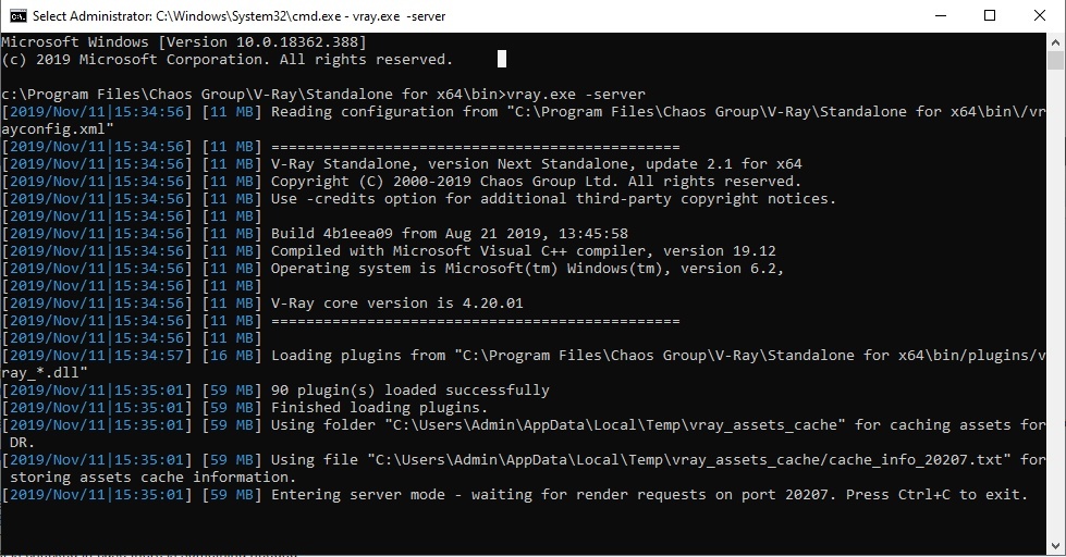

    You need v-ray standalone running/listening on render node. You can run it in cmd line with vray.exe -server , you should get something like this.

      Hi Psanitra, thanks for your help.
      It's saying some vcxxx dll are missing.
      i will try to find vc runtime. Did you know where to find the goods ones ?

        ok know i installed them from Microsoft web site. the server is now running like you.
        WHen i'm starting the render :
        on the rendernode windows :
        [2019/Nov/12|10:04:10] [59 MB] Starting DR session from 192.168.1.23
        [2019/Nov/12|10:04:10] [59 MB] error: DR request received from client 192.168.1.23 using V-Ray version (0). Render server V-Ray version (42001).
        in the houdini Console :
        VFH [Info] V-Ray: Server 192.168.1.11:20207: The render server is using a different V-Ray version (42001). Client version (0). Ignoring DR request.
        VFH [Warning] V-Ray: Render host desktop-bpmrb48 (192.168.1.11:20207) is not responding
        VFH [Warning] V-Ray: Slave dropped and there are no more render hosts that can work on the scene. Waiting for a host to connect...
