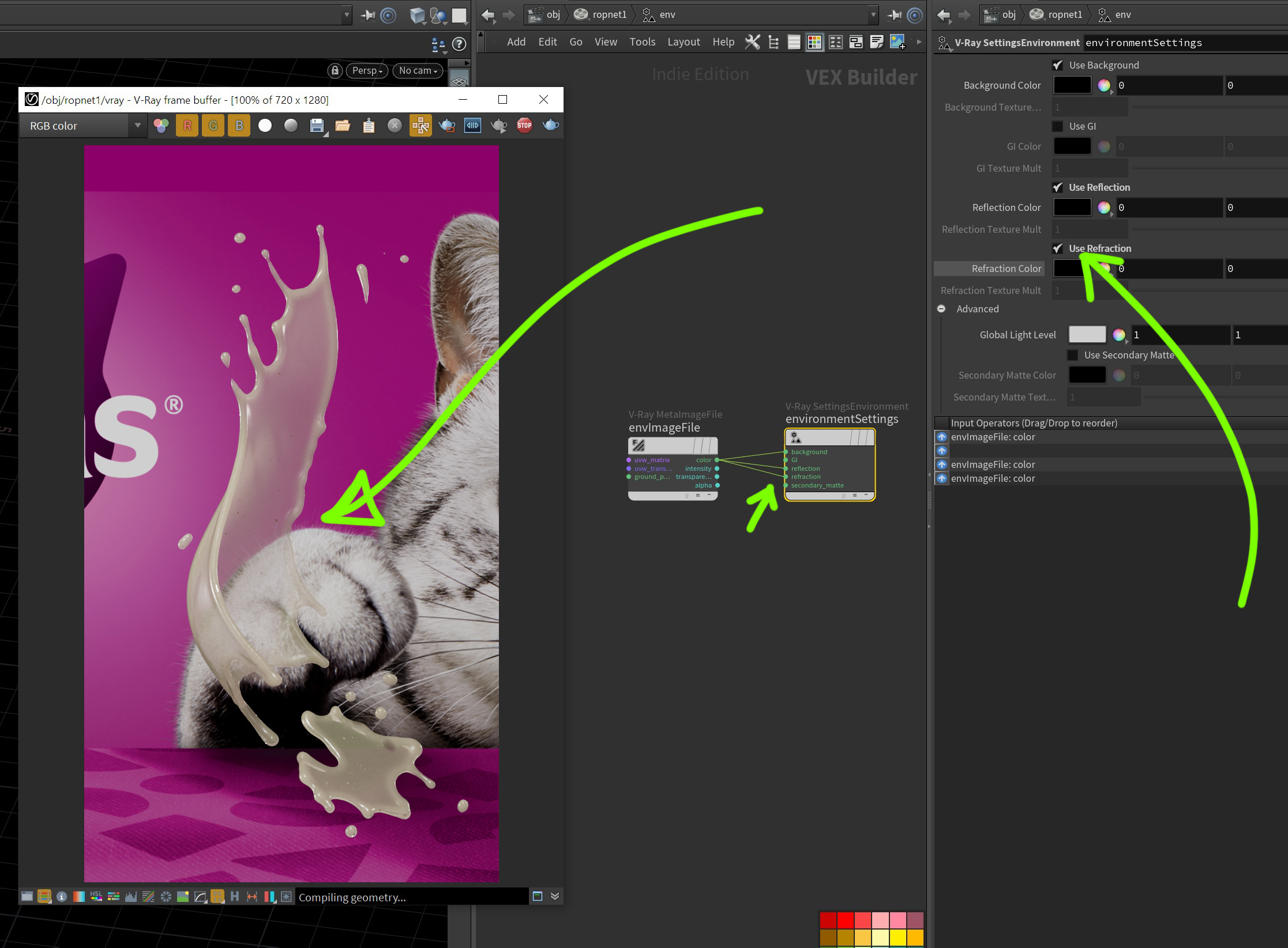

    As per title bg not refracting.
    Any help appreciated.
    J
    For some reason, if background image mapping is set to environment/screen refraction is not working. Could you try this setup as a workaround.
    V-Ray UV Projection [type:Perspective ; camera:"path/to/camera" ] > V-Ray UVW To Texture > envImageFile (UV type:Explicit)
    Click image for larger version  Name:	BackgrounNotRefracted.png Views:	0 Size:	583.5 KB ID:	1078762
