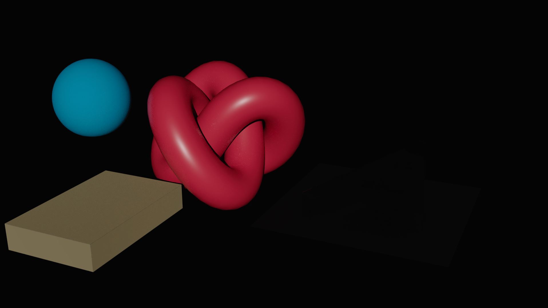

    I'm trying to get some assets from 3dsMax to Houdini using vrayScene exports but I'm running into some issues.
    I setup a small test scene to examplify the transfer from 3ds Max to Houdini, you can also find it attached in the next post (exceded 5 attachments).
    When using the vrayScene with no modifications it rendersare close result in Houdini. There is some differences in the noises, but the size and color corrections are there, but the bump on the gold bix is bugger and the displacement is a bif off in the red torus.
    Left 3ds Max, right Houdini.

    The big issues start when scaling the vrayScene data, since 3ds Max is in Centimeters and the cata when imported is in meters so it needs to be scaled by 0.01 in Houdini to match to the rest of the data used in Houdini.
    In this example I had to turn off displacement as it was taking over the whole scene. But also every paramenter that was size based (vray dirt, displacement, vray color2bump and vray edge txt) are all incorrectly scaled and still rendered at the original size:
