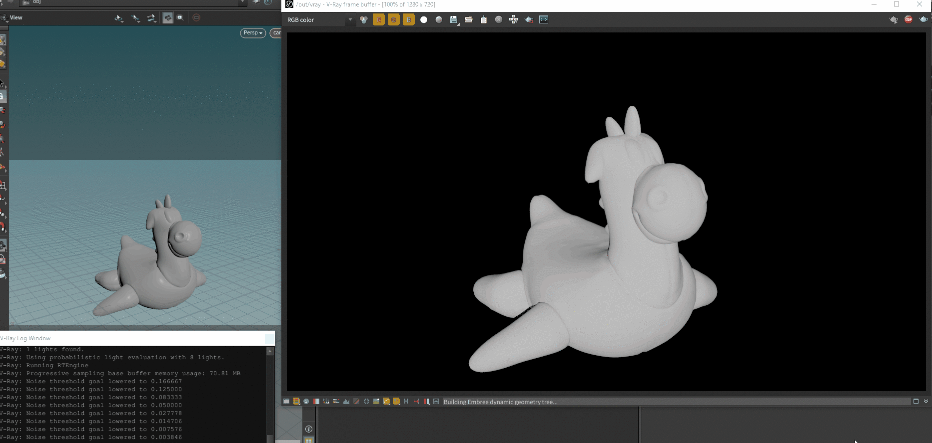

                  We briefly talked about this last week and you guys mentioned that this should be better now, but just tested with today's build and the issue is still ongoing.

                    Hmm, it seems it's far worse with "Export View Continuously" disabled in the viewport options. I've logged it for the devs to check. The fix was also for Solaris since the same issue was present there. We'll look again.

                      Hey all,
                      The issue should be resolved in the latest nightly builds.
                      Best regards!
                      gosho.genchev@chaosgroup.com

                        Hey Gosho.Genchev,
                        Definitely not fixed.
                        Click image for larger version  Name:	camera_snap.gif Views:	0 Size:	1.45 MB ID:	1107215
                        V-Ray for Houdini number:12440 hash:557fae6 from 13 Mar 2021 02:57 (build number:12440)
                        V-Ray Core 4.30.03 [14fe1e94] from 12 Feb 2021
                        EDIT: This seems to work in the V-Ray 5 builds, so the problem only persists in Next.

                          Thanks david.anastacio , I've reproduced and reported it.
