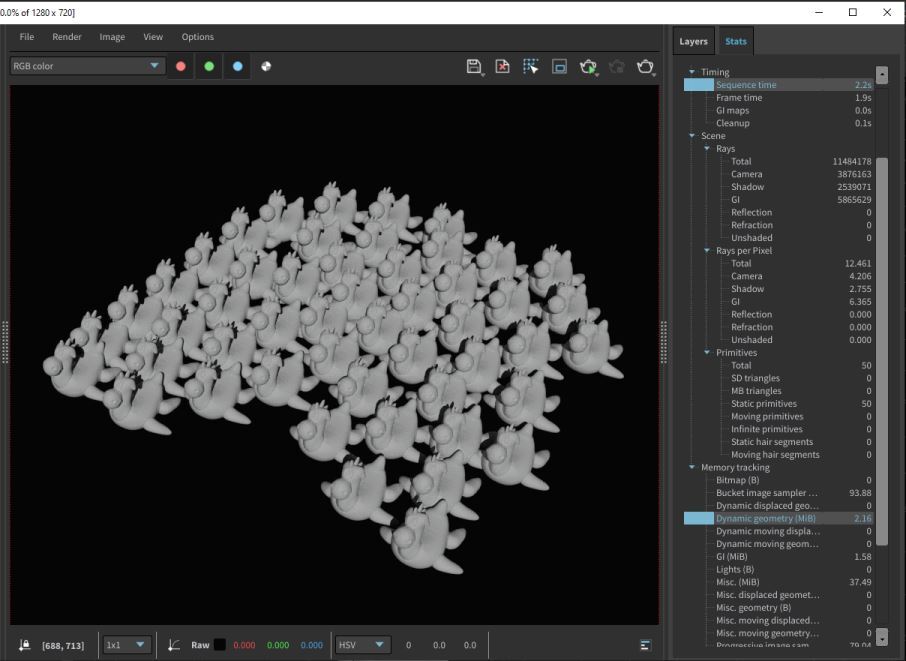

              Simple test scene with instancing of an alembic mesh. Bucket render mode, GI on with default settings.
              Default scene for establishing our baseline, alembic loaded into an instance node with 50 points, 2.2s total render time and 2.16Mb of dynamic geo, all good here.
              Click image for larger version  Name:	default.JPG Views:	0 Size:	65.0 KB ID:	1100855
              Same as before but openSubdiv ON with 2 divisions. 2.5s and 25.33Mb of dynamic memory, perfect.

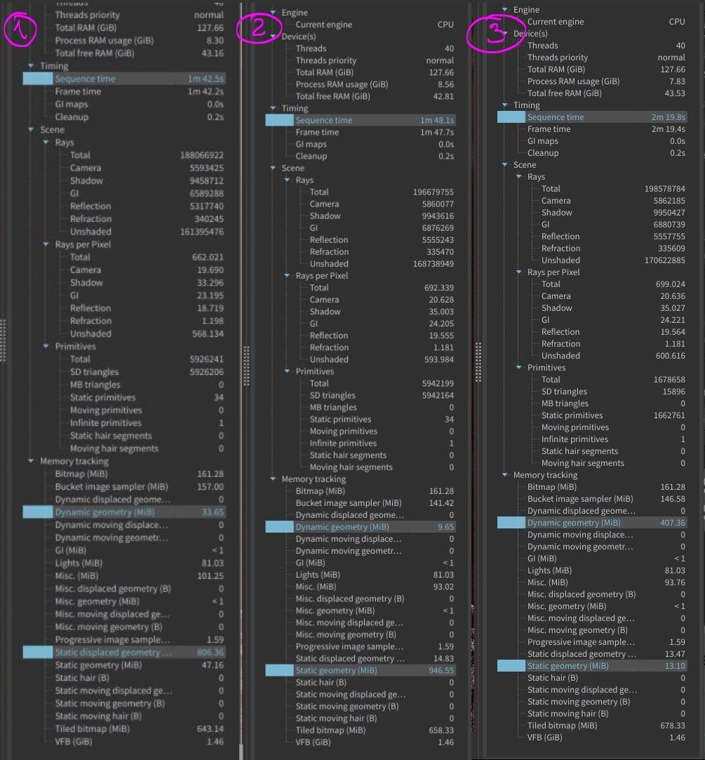

              In addition, I gave it a try with an asset with with full shading, some UDIMs, regular displacement, and openSubdiv came in faster to render.
              1 - Displacement (Pre-tesselated) + openSubdiv: 1m41s,
              2 - Displacement (Pre-tesselated) + Displacement subdivision: 1m48s
              3 - Displacement (On-the-Fly) + Displacement subdivision: 2m19s
              Click image for larger version  Name:	asset.JPG Views:	0 Size:	155.7 KB ID:	1100859
              At this stage I don't see why we would switch to displacement subdivisions at all, and unless there is something quite wrong in the current V-RAY builds were the render subdivisions are not working as intended I would suggest to bring back the openSubdiv tab so users can use it without having to unhide the parameter.
