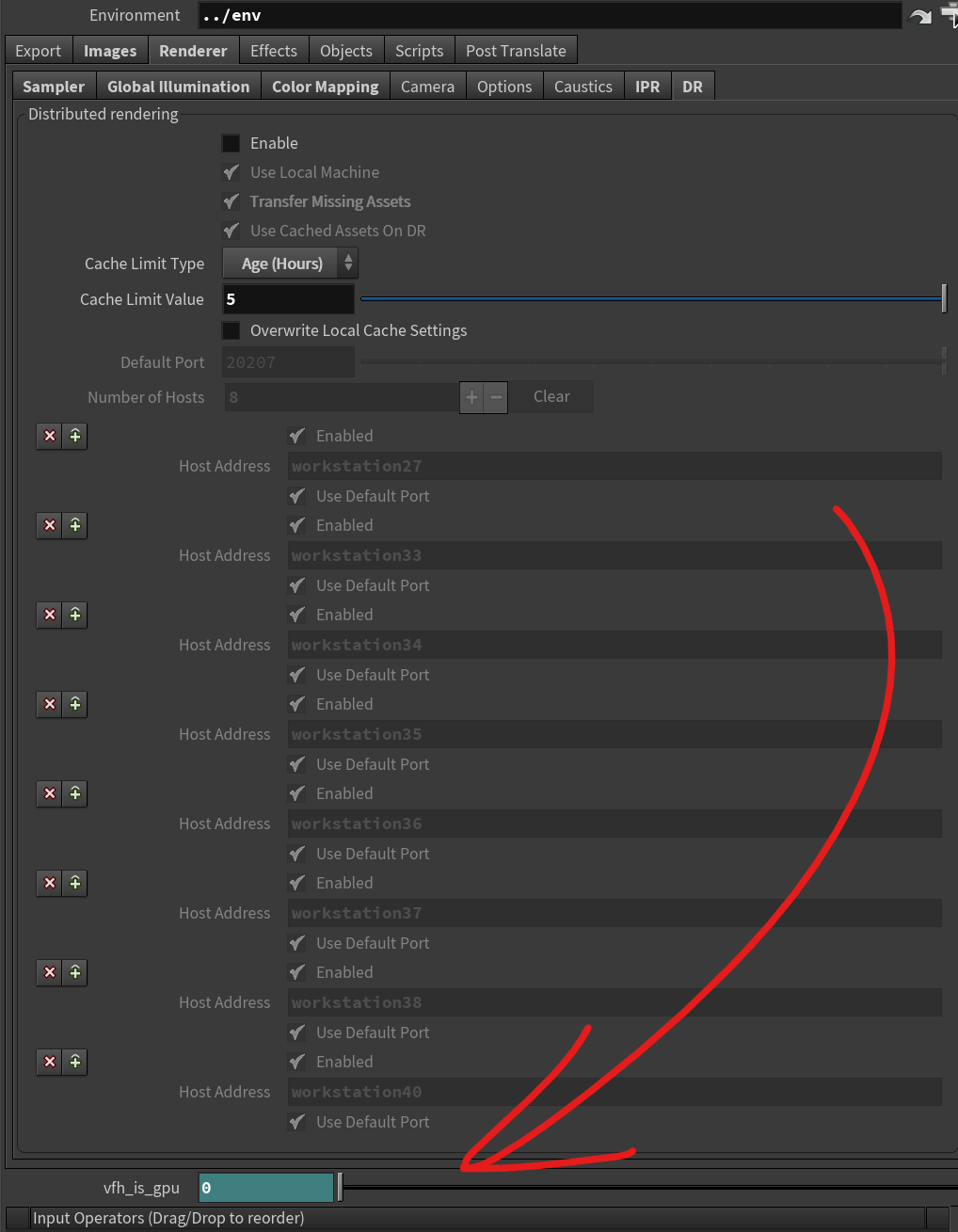

    I note that since upgrading that I get a error on load and something gets put in a spare parameter...

    > V-Ray: Render host workstation37 (192.168.0.81:20207) is not responding
    Well, you'll have to check that V-Ray versions are the same (same VFH build used) and firewall not blocking anything...
    It's because you probably have edited parameter interface, this parameter doesn't affect DR in any way anyway.

    Support Request
      Hi bdancer,
      We've seen that "vfh_is_gpu" here too, whenever we opened a scene with an older VFH build that error shows up. So it looks like this attribute was removed from the ROP in the latest builds.
      VFH 4.3, 11 November build, opened with VFH 4.3, 07 of February build:

        It even says that it's a warning not a error... This won't break anything.
        andrei.izrantcev@chaos.com
        Support Request
          Yes, nothing is affected, this was just in regards,
          The parameter wasn't added by any user, was just the result of the warning and getting converted to a spare parametter.
          best,
          David.
