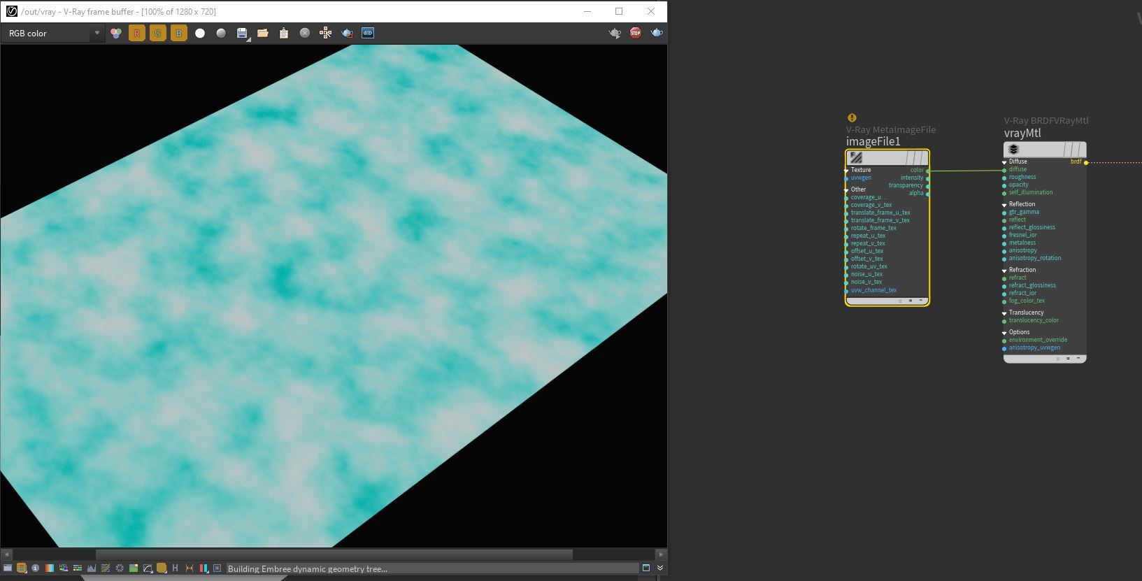

    Hi again,
    Looks like frame sequence options in the image node are broken again. $F works, but end conditions and offsets don't.
    Image sequence when it's inside the existing frame range:
    Click image for larger version  Name:	sequence_1.JPG Views:	0 Size:	80.7 KB ID:	1102822
    Image sequence when it's outside the existing frame range, and end condition set to loop:
    Click image for larger version  Name:	sequence_2.JPG Views:	0 Size:	52.7 KB ID:	1102821
    Image sequence uses $F, and in the sequence options we tried ON and OFF of the "Frame Sequence", with and without $F in the "Frame Number".
    And all the options in the "Image File List" are not working.
    Click image for larger version  Name:	sequence_3.JPG Views:	0 Size:	13.6 KB ID:	1102820
    Can we get a quick fix for this please.

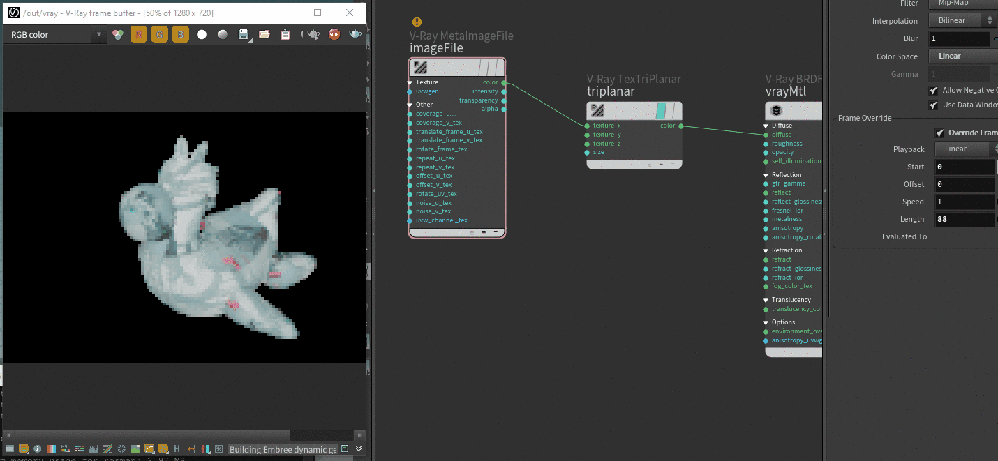

          Btw I just tried to render something on Vray Cloud with sequence of bitmpas in displacement and $F4 does not get through... Locally it works fine but Vray Cloud app gives me an error that it cannot find the file specified (and it reporst the name of file without frame number)

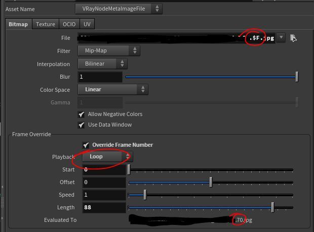

              Hi again Gosho.Genchev,
              I tested the current state of the new Frame sequence options and found some issues.
              When using any option other than the "linear" mode the frame number is incorrectly evaluated. In Linear is correctly evaluates to 4 frame padding, but in Loop it only returns 2 Frame padding. (We always use frame ranges with at leas 4 frame padding and start usually the frame range at 1001)
                Could you please change the Start/Offset/Lenght a bit to make sure the set up is correct? Initially I wanted to not even have an "Offset" option but that meant using the Time slider's Start/End as anchor points for the sequence when in Loop/Ping-Pong/Hold. Thus changing the range of the timeline would mess things up. Now, the Offset is assumed 0 and used as the anchor. Hopefully that makes sense somehow ...
                Anyway, why not use $F4 if the issue is the frame padding ? The "Evaluated To" result is simply a call to hou.parm(#File).evalAsStringAtFrame(#current_frame )
                  I tried adding now the $F4 , it added the missing 2 zeros, but this is a solution yes but not great as everything else always works with $F and even in linear it works with $F so it won't even cross people's minds do check it with $F4. Plus to make it work I need to change my start frame to 1001, when in Linear it had to be 0.
                  In the other modes it always resolves to starting the sequence from 0 and in my case the sequences starts at 1001.
                  Additionally the "Length" parameter might cause issues, as it forces us to always specify the length of the sequence. Example, I make an HDA where a plate is loaded, and that plate will have different lengths in each shot, now in addition to specify the plate path I also need to specify the length, and if the plate length is adjusted/modified by editorial I need to go to the shot manually and correct it. The "Length" parameter should not exist, should always take the texture range and in case you really need it then it should be an option and it should be off by default.
                  Also the start frame should not be 1, should be 0, 1 introduces a 1 frame offset.
                  And finally, the start frame currently is not working great, in Linear I need to set it to 0 although my frame range starts at 1001. It there is a Start frame defined then my frame range should start at that Start frame in all modes (Linear, loop, ping-pong and Hold) no matter what the first frame in the texture sequence is (1, 100 or 1000 all should be offset to start at the "Start").
                  If I didn't have that "Evaluated To" would be really hard to line up a plate when changing to loop, ping-pong or hold to the right frame.
