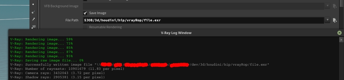

    hello!
    when using a path in save image file the file never gets saved because the path changes
    like this:
    /folder/folder/file.exr (what we want)
    \\folder/folder/file.exr (what it becomes in the log)
    $JOB/file.exr
    $HIP becomes correct
    linux centos7
    houdini 18.0.499
    V-Ray for Houdini number:10509 hash:6986845 from 04 Feb 2021 03:02 (build number:10509)
    V-Ray Core 5.00.50 [543f92aa] from 1 Feb 2021
    Regards Alexis

    And what is $JOB value?

      its a houdini environment variable that on linux gets evaluated to //folder/folder/file.exr but when rendering it becomes \\folder/folder/file.exr which doesnt exist
