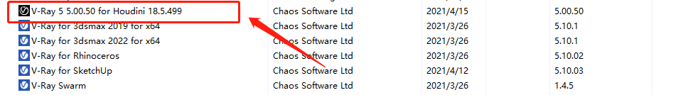

    I installed V-Ray 5 for Houdini 18.5.499, (13036)
    But I did not find V-Ray in Houdini Shelf. Is there a problem with my settings?
