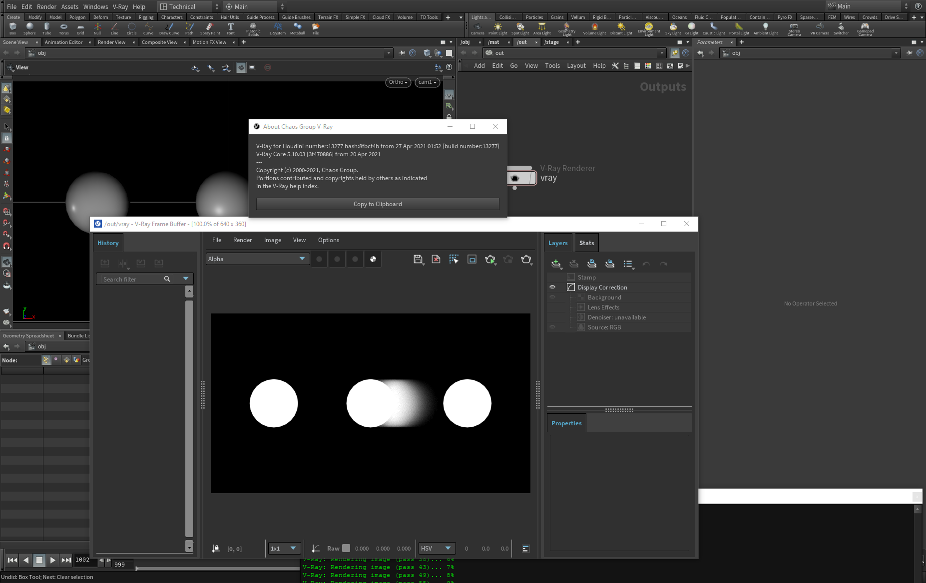

          Hey Alexis,
          I've verified this working on both Python2 (18.0.499) and Python3 (18.5.532) builds for Windows and Linux. Could you please check the Main Menu -> V-Ray -> About V-Ray to make sure the correct build is loaded? I'm out of ideas for troubleshooting.
          Best regards!
