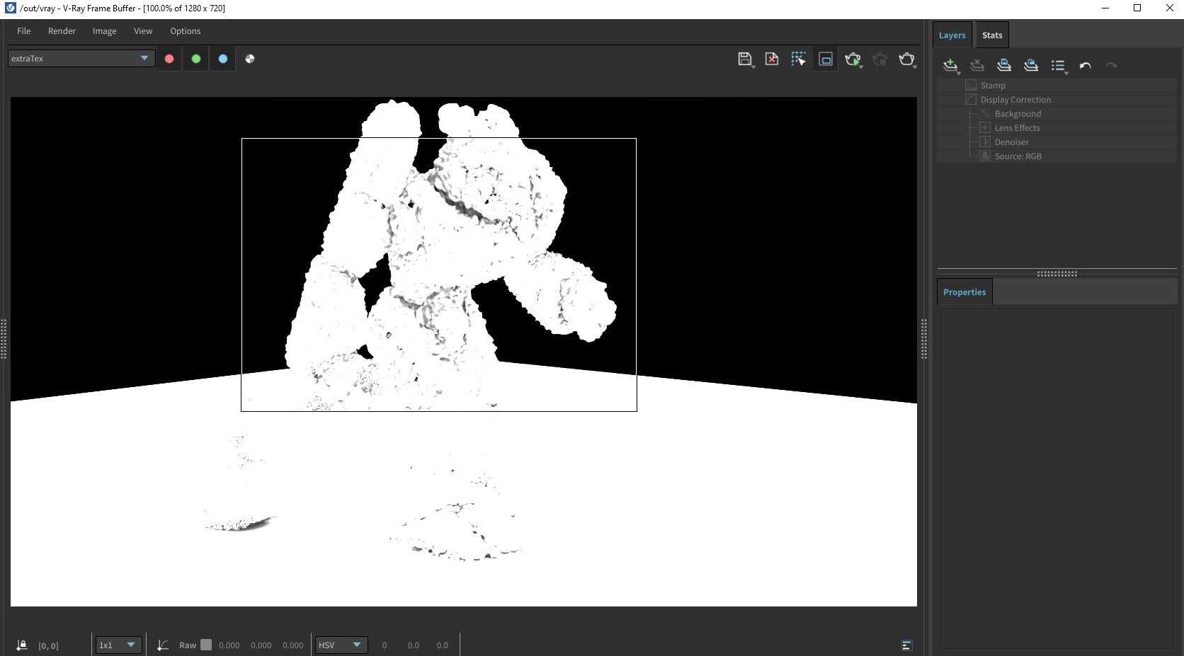

    Hello.
    I was trying the last version 5 update 1 and it seems very solid but I found a extrange behaviour:
    When I add an extraTex render element with a VrayDirt to have an AO pass it works ok but as soon as I active denoise in the extraTex the render appears overexposed but only when the render is finish. While is rendering it look ok.
    When I use IPR for rendering it look ok all the time.
    www.gaell.com
    Hi gagui , can't reproduce it on my side, can you share the scene ? What are your OS, Houdini and V-Ray versions ?
