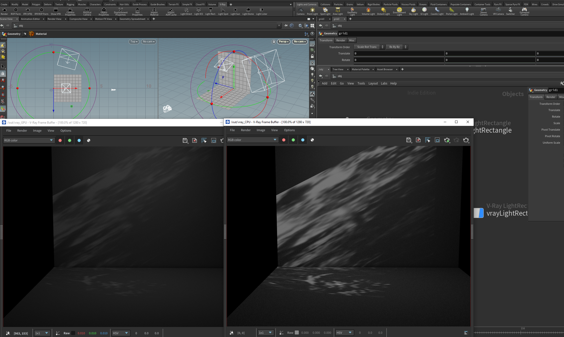

    Hi, Light texture doesn't render properly in GPU mode. It looks darker and doesn't update when intensity value is changed. Any way to fix this? As our project workflow is GPU interactive based it is very annoying. Thanks

      Hi chakarov ,
      I am using 18.5.596 on windows 10
      V-Ray for Houdini hash:fb365cd from 16 Jun 2021 11:44
      V-Ray Core 5.10.20 [5322b47e] from 4 Jun 2021
      Driver RTX 2070 471.41
      See attached files.
      Thanks.
        The problem seems to be caused by the Directional parameter of V-Ray Rectangluar Light, I've reported the problem. As a workaround the closest value where the problem does not appear is 0.99888.
