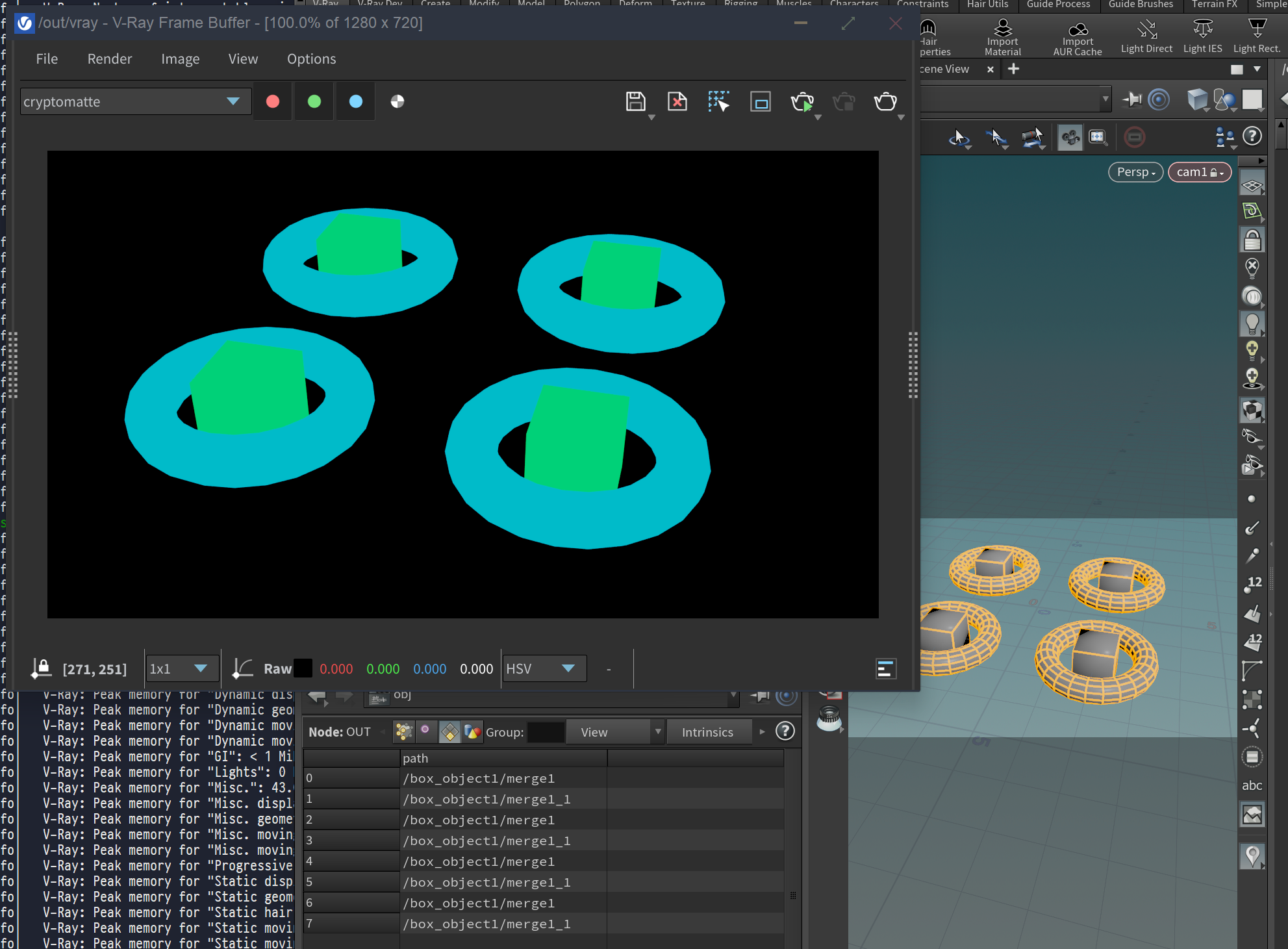

    With rayserver instancer enabled the path attribute is no longer recognized in the per attribute value cryptomatte.
    In my demo scene, I have the packed alembic primitive with the path attributes, a grid to use for points, and then copy to points. On my geometry container I have the Vray object properties added and Rayserver Instancer is enabled.

    If I create a per attribute value cryptomatte render element and specify the path as the attribute to be used, the cryptomatte will render one solid color.

    But now if I disable rayserver istancer in the vray object properties then the cryptomatte behaves as expected and I get a unique value per unique path.
