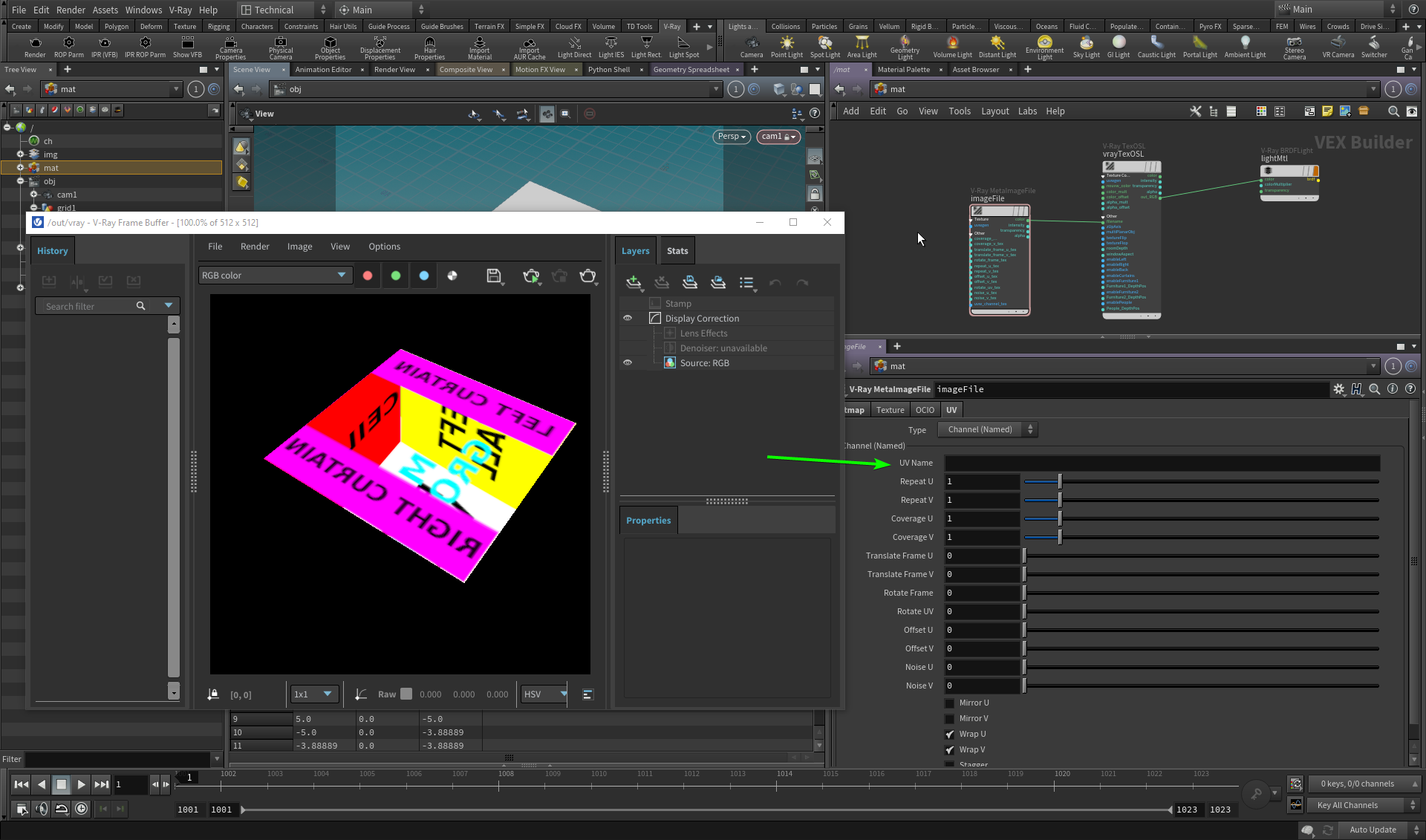

          Hello daeschri ,
          just checked it, seems that the problem is caused by "uv" attribute used in ImageFile UV tab. If you remove the name of the attribute / empty parm /, the OSL texture is rendered as expected.
          Click image for larger version  Name:	solution.png Views:	0 Size:	428.5 KB ID:	1129882
