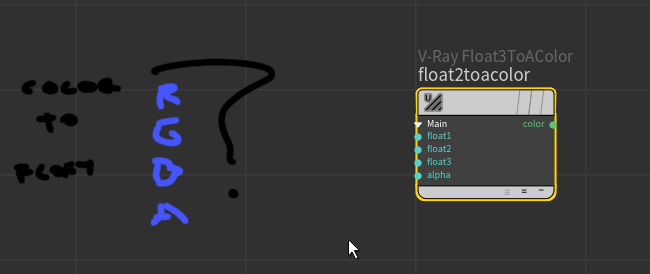

            Thanks, I saw in the latest daily and I believe is working, however, how do you split color into float or vector to float in Vray, I tried to look for a node but I didn't find it. You have a color to float but is a single. I added what RS has and also you can just compare it to Houdini's own vector to float. Maybe a missing something here?

                forgot about this one - thanks for the reminder! I still wish was something more like a vector to float straight from Vray.
                  Yeah, a single node that handles vec2float would be greatly appreciated. What about performance? Is there any performance impact by using 3 color channel nodes to convert a vector to floats in comparison to a single node solution (that is currently not available)? If so, that would push the need for such a node even more.
