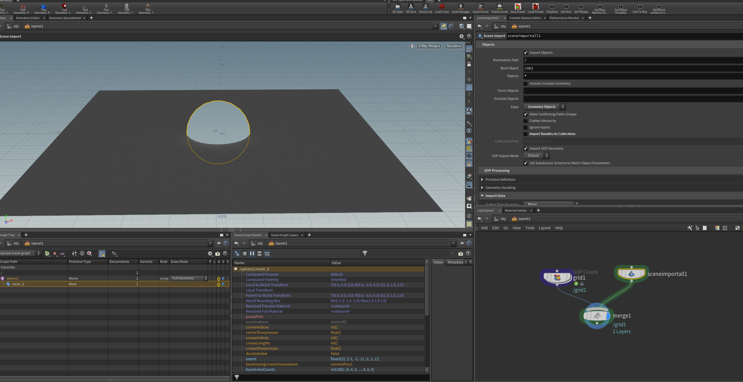

    When i load in a geo with scene import everything seems fine in karma and in the scene graph but the object renders as it would be a holdout.
    Click image for larger version  Name:	sceneimport.png Views:	49 Size:	697.0 KB ID:	1134490

    Since I didn't see any updates or that some kind of workaround existed just bumping the post saying I'm running into the same issue where scene imported geo is invisible.
      Dentzz, I'm not sure which version are you using, but this was fixed at 18th Dec.
      Todays nightly build has an issue with Hydra, so I'll recommend using build before 27th or wait for tomorrow build.

        I was using the release version and didn't see any comment in the thread as being addressed, good to know it will be fixed though.
          This seems to work now, thanks!
