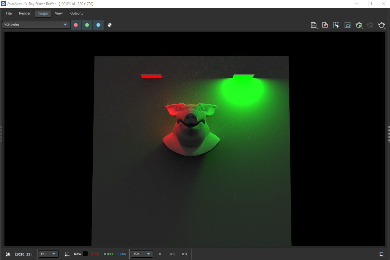

    Hello. I've notice that GPU rendering of lights with objects mask works ok locally but once the scene is sent through deadline or to chaos cloud this disables totally the light.
    Is this a known bug or somethig you were aware of?

      I also attach two images. The first one has been rendered locally with GPU RTX engine, all ok. The second one is exactly the same scene rendered through deadline in the same computer using export option of deadline.
      As you can see the red light which has only the pig included in the Illumination Mask list in the local render doesn't affect the grid as expected but in the other image the light seems to exclude all the objects or something.

          Hello gagui , looks like V-Ray Standalone can't work with illumination masks exported by V-Ray for Houdini. I've reported it. As a workaround if you use V-Ray for Houdini as Standalone, the problem will be solved.

                The builds for the Chaos Cloud have been updated to support the Illumination Mask export from Houdini.
