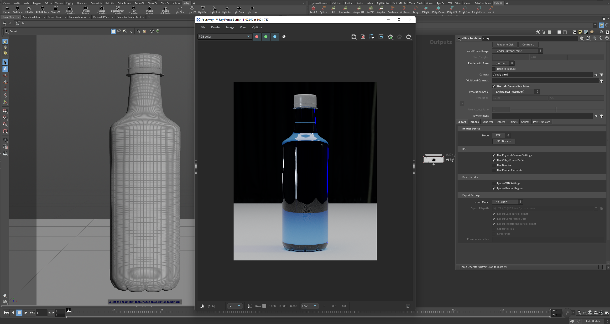

              Hi Tsvetomira!
              Any news on this? I'm using vray 6 now and I can see some improvements but still not 1:1 match between CPU and GPU.
              One thing I can notice now is if I render only the plastic bottle without the water it renders the same in GPU and CPU and if I render only the water without the bottle it renders the same too. Only when I render both bottle and water is when I get different result.
              Click image for larger version  Name:	GPU_problem_1.jpg Views:	0 Size:	199.3 KB ID:	1174429 Click image for larger version  Name:	GPU_problem_3.jpg Views:	0 Size:	141.5 KB ID:	1174430 Click image for larger version  Name:	GPU_problem_2.jpg Views:	0 Size:	228.4 KB ID:	1174431
