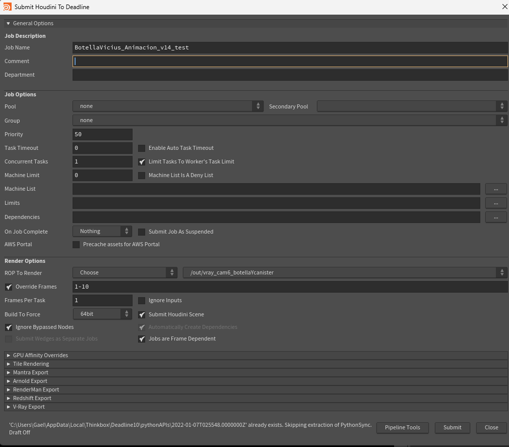

    Here I show you some captures of the error deadline is giving me.
    By the way, why is deadline making a task of 10 frames when I set it up to make 1 frame per task?

      Today I've tried to render a deadline job in the same computer it was sent through deadline worker and I'm getting the same error. What could be the problem here? I'm a bit lost
