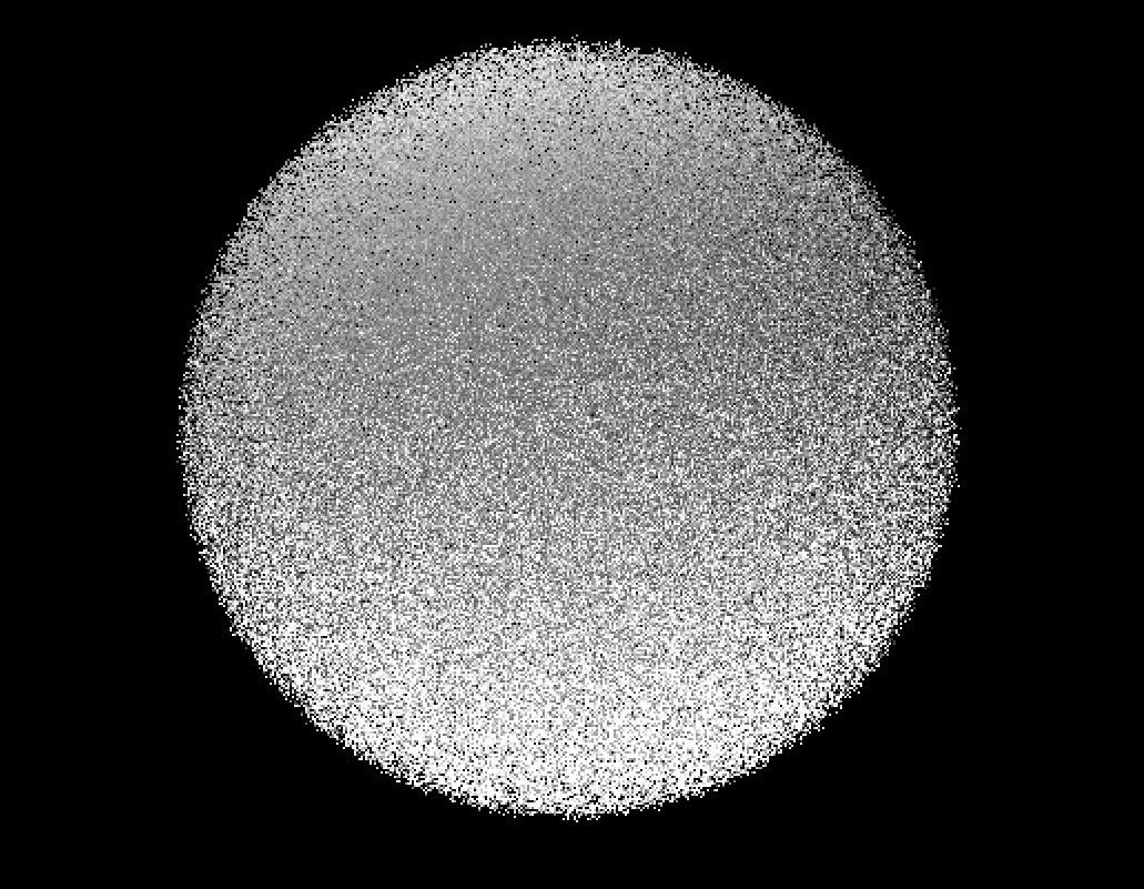

volume very slow rendering, just a very simple vdb sphere
  • volume very slow rendering, just a very simple vdb sphere
    it's a simple vdb created from vdb from polygon , I know volume could be slow, but not this much.
    after ligth cache finished computing, it takes very long time to proceed for actual rendering, did I do anything wrong , or this is vray speed for volume.
    the vdb only 10MB in memory, with 2 vray lights.
    houdini 19.5.5.551 windows 10,V-Ray for Houdini number:22320, cpu mode​
    Hi len_xie, the slow down is caused by reducing volume density ( "scale" parameter in Smoke tab of the shader ) which allows light to penetrate deep in the volume. In order to reduce render time you could try tweak "Step" and "Shadow Step" parameters in Rendering tab of VolumeGrid Shader.
    Georgy Chakarov | QA
    www.chaosgroup.com
    georgy.chakarov@chaosgroup.com
      @chakarov​ hi, I tried to increase step and shadow step to maximum value but it's the same, but I found that by turning off Probabilistic Volumetrics, can improve a lot.
        len_xie try upgrading to a new build. There habe been issues with volume rendering speed that have been adressed not too long ago.
