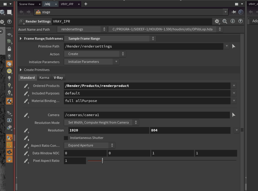

    I'm currently trying to render with Vray Solaris but I can't render my image... I referenced everything between the nodes but when I render to disk I get an instant error...
    i'll post you the pictures of the error and also of our nodes above​
    Thanks for the futur help and take care !
    The usdrender_rop error:
    Click image for larger version  Name:	image.png Views:	2 Size:	27.1 KB ID:	1207799
    the render setting :
    Click image for larger version  Name:	image.png Views:	1 Size:	109.7 KB ID:	1207801
    and the render product node :
    Click image for larger version  Name:	image.png Views:	1 Size:	81.3 KB ID:	1207802​​​

    Hey thanks a lot for your help ! Yeah I finally use it yersterday and I see my error ( unfind camera ), because I forgot to save my scene in USD with my configure layer node haha
    btw how did you keep it open in a side window ?
      PS: it's in Solaris not in Sop
            When you make a new window, you can pick the type of window, and there is solaris/log view
