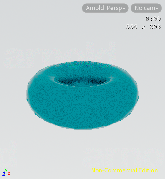

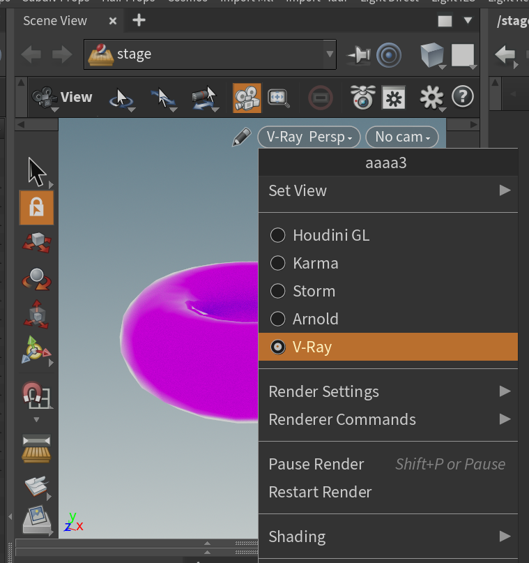

                      V-Ray renders pink for me no matter if Arnold is activated or not:
                      Click image for larger version  Name:	15_09_2023_18-27-31.png Views:	3 Size:	322.2 KB ID:	1190842
                      Karma renders cyan no matter if Arnold is activated or not:
                      Click image for larger version  Name:	15_09_2023_18-27-15.png Views:	3 Size:	323.5 KB ID:	1190843
                      Arnold renders bluish material:
                      Click image for larger version  Name:	15_09_2023_18-27-09.png Views:	0 Size:	348.7 KB ID:	1190845
                      Both are deployed using package files.
                      Houdini 19.5.716.
