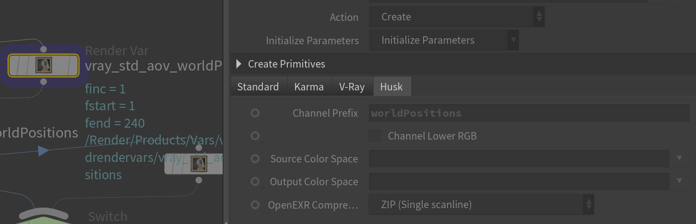

                            • #15
                              > on each RenderVar
                              Could you be more specific? Cause I see those set e.g. here:
                              andrei.izrantcev@chaos.com
