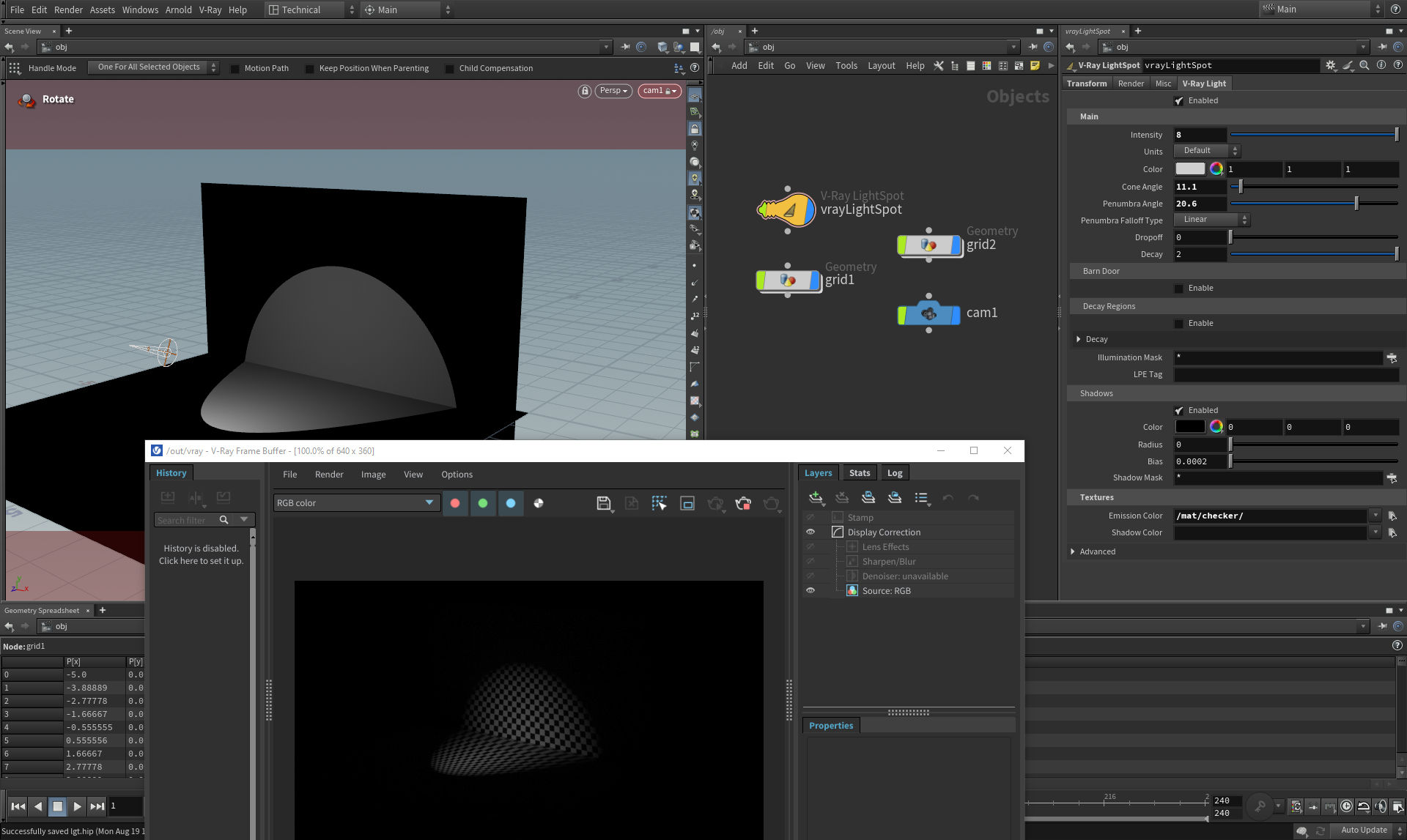

    Im trying to create the look of a film projector in solaris. So far I have tried a rectangle light with a light filter, but as soon as I turn the direction of the light down the image get super blurry. Is it possible to do this with a point light or is there another solution?

      No I get the same result as you but I would like the projection to be emitted from a smaller point, like a cone as you get with a film projector. Im also using fog to simulate the rays.

        Hey RichardBlank ,
        That would be a 'Spot' light then, correct? I've attached a screenshot from 'vanilla' Houdini below - it appears we haven't added light filters support for the spot lights in Solaris - I'll log it as a feature request.
        It's doable in Solaris as well - the "Point" light type has to be selected, and "Spotlight" enabled in the Shaping options below. I'll keep you updated on the light filter support with this workflow.

            Hey RichardBlank ,
            That is my point - it should work as a light filter but currently it does not. I'll check with our devs what can be done about this, and get back to you.

                Hey RichardBlank ,
                There is now support for light filters when using the Spotlight option under the "Shaping" tab of the lights in Solaris. I've attached a simple example scene below.
