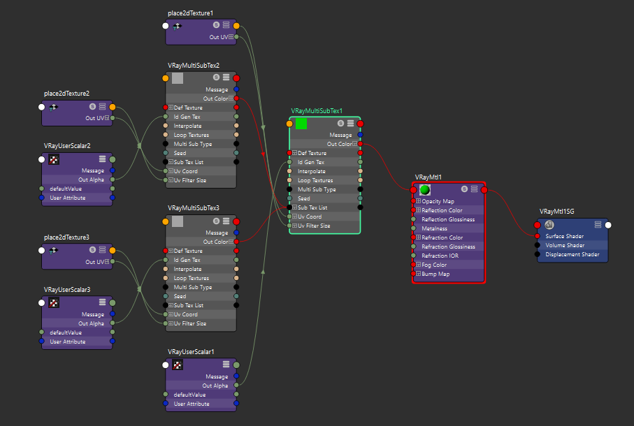

    Try creating a "major" VRayMultiSubTex with VRay User Scalar as Texture switch, to control the textures set (Wrapping or ribbon). The user attributes for this MultiSubTex should be set in the objects' groups.
    Next, create two other VRayMultiSub textures with their own VRay User Scalar node to control the switch textures. The user attributes for these MultiSub textures should set on the objects themselves.
    Attaching a screencap of the shader setup and screenshot from the result.
