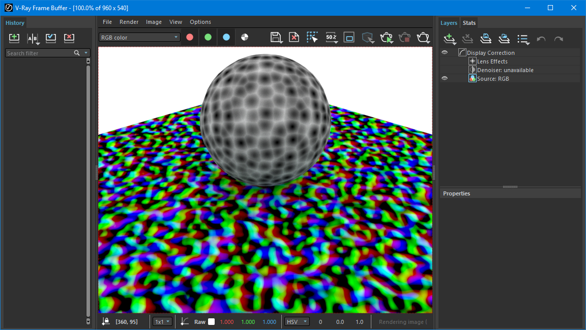

              Hello Matthew,
              The Wombat code is fine but it's just a collection of functions and not full-fledged shaders. In order to see anything, a main function is needed (the entry point of the shader) which is expected to produce output by writing to gl_FragColor. I'm attaching a couple of very simple shaders, based on Cellular3D and Perlin3D_Deriv, just to illustrate how these can be turned into real shaders.
