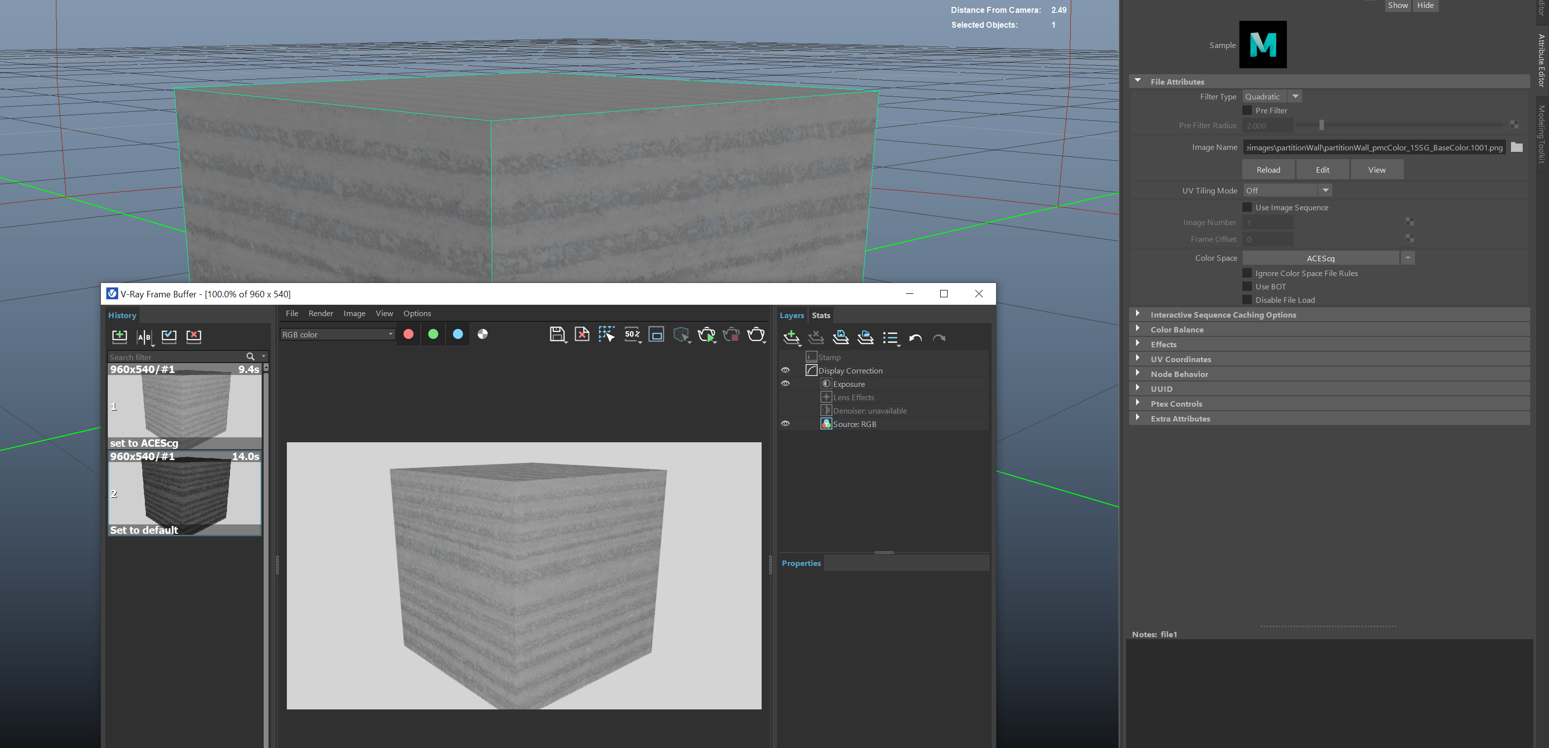

    Just wanna check I'm doing this the right way. I've followed this guide for setting up Maya and Vray with ACES. I'm currently using the second option (I think) but the color management page of Maya is slightly different in the latest version - Maya 2022
    You'll see the settings I have selected in the screenshot attached
    And then in the VFB I've opted for the Display Correction method with the OCIO option selected. I seemed to be getting a slightly different result when using the 'filmic tonemap' approach, maybe I'm missing something in the workflow.
    Saving to an external EXR or batch rendering saves images out without the VFB correction from what I can see - this is preferred so you can colour correct using ACES colour range in post, as opposed to baking ACES into the image sequence
    In After Effects my project settings under Color are 32bit, Working Space 'None'.
    I'm interpreting the EXR as 'preserve RGB'
    Then I'm applying an adjustment layer over everything with the OpenColorIO plugin reading the same OCIO config that's being read in Maya.
    Am I doing this right?

    Hi GregCooper
    Your setup is correct, good job!
    For me personally I prefer using the ACES 1.2 config, which is the latest official release. The difference is that it will give you control over your color picking in Maya, I explain this here
    About the filmic tonemap approach, you will need to set Display correction to None. Then Add Filmic Tonemap layer, set it to AMPAS and change the Gamma to 0.8
    The ACES documentation will get updated soon, and the team is working on improving the AMPAS preset to match without needing to change Gamma
    Yes, as long as you save in EXR, you will keep the scene-referred values untouched and you will be able to comp light AOVs for example
    And you have the option to do your adjustments in the frame buffer, then you can save a JPEG and burn the view transform to the file. You will find an option for that in the Display correction

        Interesting, I thought the Input colour space in the Maya prefs had to be set to ACEScg and not default?
        Maybe this is where I am going wrong!
        Setting it to default for me produces much darker renders, Setting it to ACEScg produces a render similar to the texture file.
          Input Color Space needs to be set manually for textures,
          -For color channels (diffuse/reflection/translucency/textured lights) you need to use Utility-sRGB-Texture for 8 bit formats like JPEG and PNG, and Utility-Linear-sRGB for linear EXRs like HDRIs (this way the correct Gamut conversion takes place during render time)
          -For roughness/Glossiness/displacement and everything else, use Utility-RAW (it basically loads the map linearly without a conversion)
          If you set this to ACEScg, no conversion is done. the texture is just loaded with a linear transfer function (ACEScg is scene-linear, so no conversion is done)
          You need either Utility-Linear-sRGB or Utility-sRGB-Texture for the correct color space conversion to ACEScg
