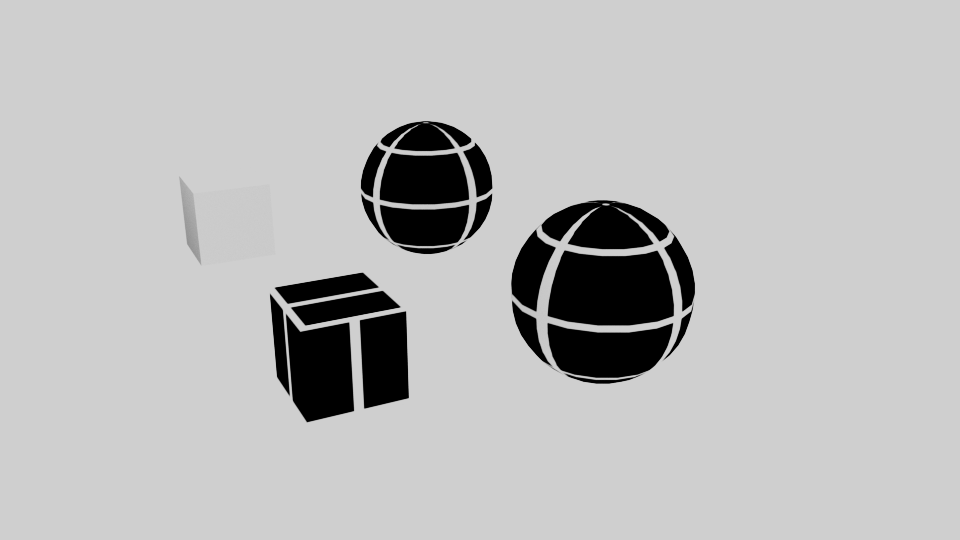

      Hi Alex,
      attached a simple scene (Maya 2022.3 + V-Ray 5.2, Windows 10) with two spheres and two cubes with a grid texture. When you export the four objects as a proxy (Use the new VRayProxy node enabled) and render the scene, some textures are missing.
      The UVset of the spheres is named "map1" and of the cubes "UVset".
      Hope that helps,
      Lars
        Right, thanks for the files. This is something we'll look into, but until we figure something out, I can propose a solution.
        After importing the proxy, find the 2d placement node of the texture and add extra V-Ray attributes to it - choose "2D placement options".
        Enter -1 for the index and this will make V-Ray take the first UV set it sees for each proxy sub-object.
