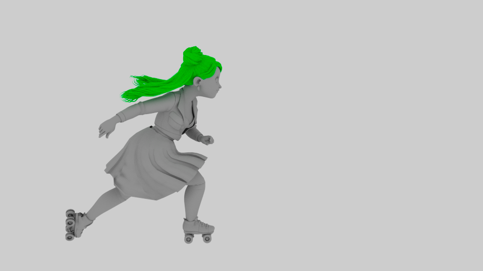

    Hi Guys,
    I am currently having some motion blut problems. Bellow there are to images with and without motion blur you will be abble to see some artifacts.
ID:	1146714Click image for larger version
    I already tried all the settings of motion blur to fix this and found no fix. The hair and the body are on my scene as a vray proxy, i also already checked if they have the velocity and both body and hair have this.
    Do you have any idea of other stuffs that i can try?
    I'm curious what is the geometry that's being loaded? is it .vrmesh or .abc? In any case it looks to me like the motion substeb with which the geometry was cached is too low, and this is why it has this issue.
    Dmitry Vinnik
    Silhouette Images Inc.
    ShowReel:
      Its an alembic, we already checked the substeps from houdini and they are ok! I already tried a bunch of things and nothing works!
        Does this happen only with this particular alembic? Could you send it via the contact form so we can take a look? Mention me and include a link to this thread.
