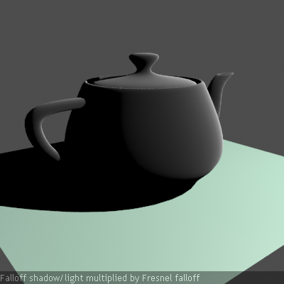

                Here are two images, one is done with a VRayMtl material with a Fresnel falloff map in the diffuse slot; the other is a VRayLightMtl material with a Shadow/light falloff multiplied by a Fresnel falloff. As you see, the results are identical.
                Vlado
                  yes, the funny thing is I already did the same test and thought I got it.
                  the problem is it's not possible to use the output of a shader inside a shading network (at least in vray for maya, it's possible in mental ray for maye and so on...).
                  so I can't use it as mask...I could only layer this shader completely in a VRay Blend Material. and that's not what I wanna use it for. It limits the amount of control I get. I can tweak the fresnel with utility nodes, but I can't tweak or use the diffuse/light output of a VRay material inside maya...
